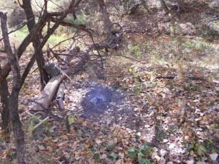

I have the 7" version done. I drove down to the river and walked in to the woods. found a scrape pile of trees the city
put next to the river. In this pic you can see the piece of cottonwood branch that I am pointing to.
I chopped a smaller branch off. then chopped up off a couple of other pieces the drill and hearth board.
debarked the 2 pieces and thenb split one and carve the drill up some and then the hearth board. Took my 17.5" long bow and then my home made bearing, did a burn in and then cut the notch and 61 strokes later I had a coal.
Just another pic of the trial area with the knife bow drill parts.

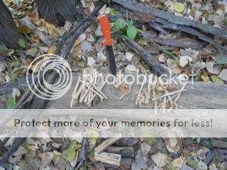

Ok on to what I did today with this knife.
I hiked out to a spot along the river that I like and have a little fire pit at. I chopped, split, and carved up some mullberry wood. I made some small kindling, some fuzz curls and then fuzz sticks.
As I was hiking out to my spot I seen a small hack berry sapling that I just had to have for a new hiking stick and so proceded to carve it( debarked it lol) up while sitting next to my fire. This sapling was pretty straight they do not come that way very often. So this one will be with me for many years to come.
all in all a pretty good day out testing this knife while out in the woods and sitting next to my fire.
I did not get any pics as it is hard to cut summer sausage and apples and take pics at the same time lol. but in the kitchen this knife is working.
