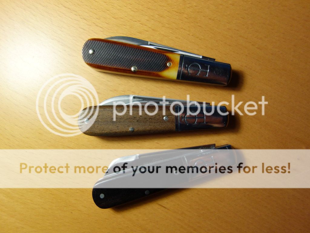

No I have not filed the kick, but yes, some of my Sheepfoot Charlow blades stick up more than others. If you can still see your blade etch, look at the R in Real. On one of my Sheepfoot Charlows only the D part of the R shows, not the legs. On another one, the whole R shows. I mean this with the blade closed and looking straight accross the liners. So yes, there is more room if your Etch sticks up like Im describing. But, what you really need is someone to educate us how to determine how deep the pocket is, so you actually know for a fact how much room your knife has to drop the blade.
But! IF you file the kick, the backspring will drop down and will no longer be flush with the liners at the pivot end. So unless that is OK with you, do not modify the kick, unless youre prepared to also modify the bolsters and liners. But! If you modify the bolsters and liners to match a sunken backspring when closed, then with blade open, the backspring will be proud. Those are the reasons I did not modify my tall Sheepfoot.

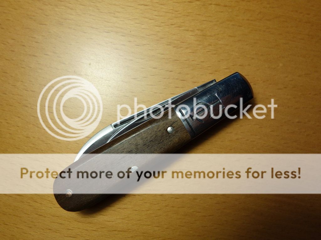

Here is a pic of the etch, that I took for posterity, since it does not last once patina starts.
ps, a quick measurement with a regular tape measure (better more accurate tools recommended), shows one of my sheep is 1/16" more proud, measured at the spine at the front edge of the long pull. The actual measurements are 4/16" from liner to spine on one, and 3/16" on another. As it happens, the higher blade is on a single blade charlow, the lower blade is on a 2 blade charlow.
