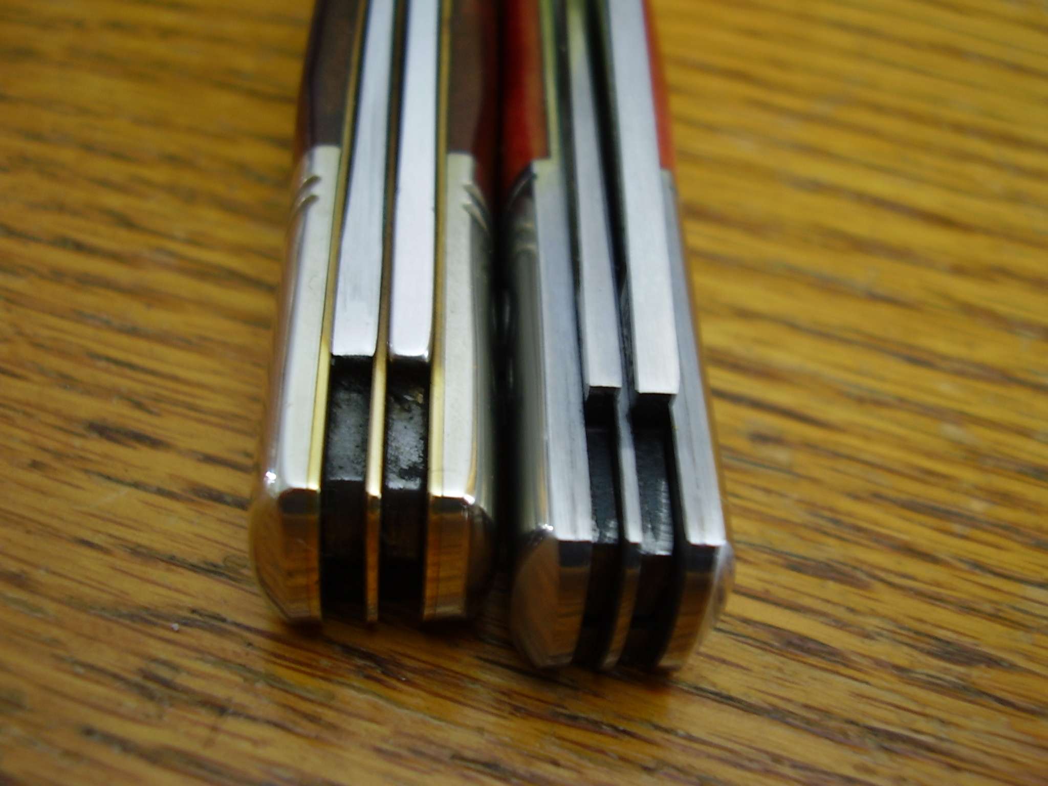

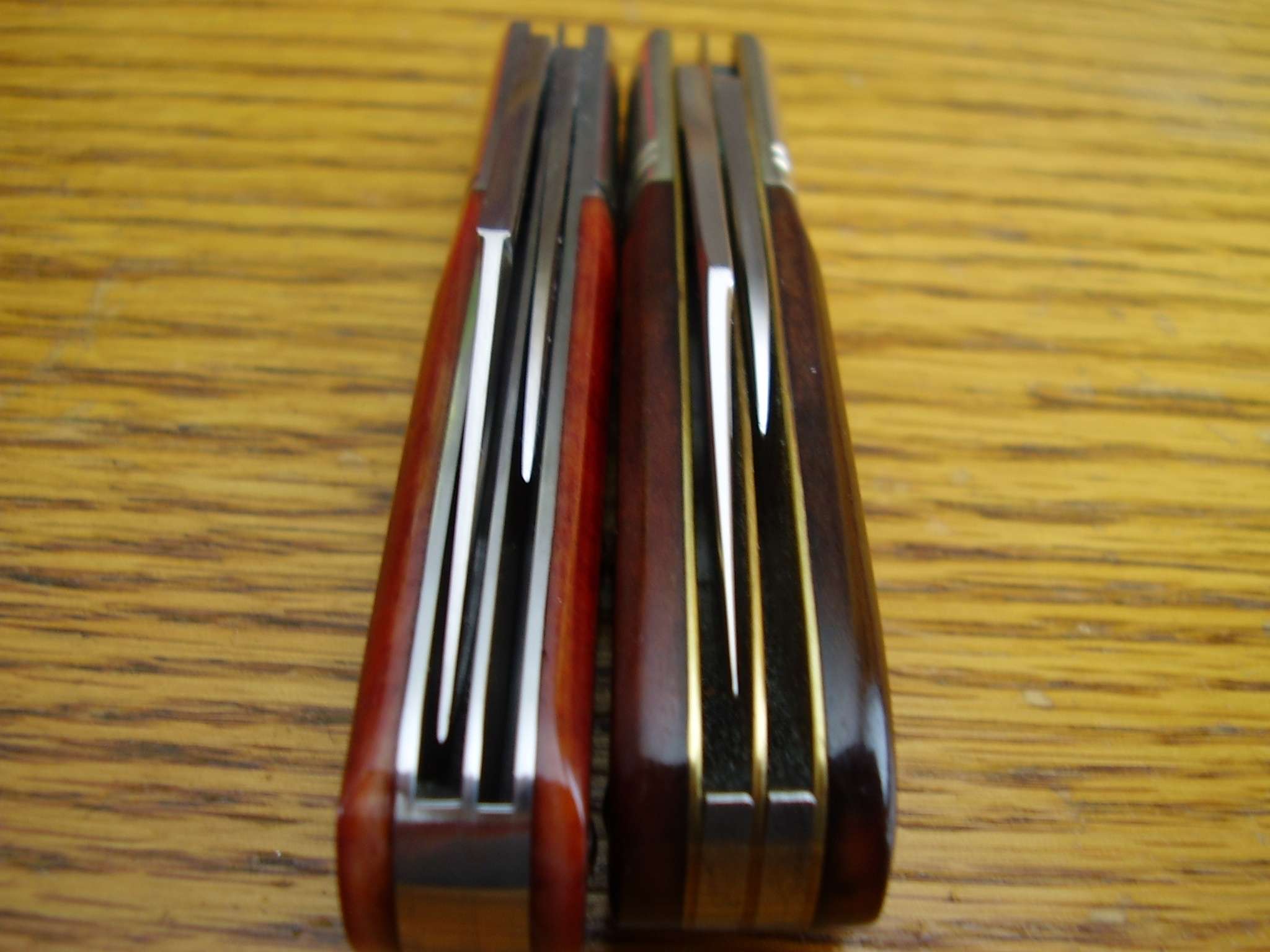

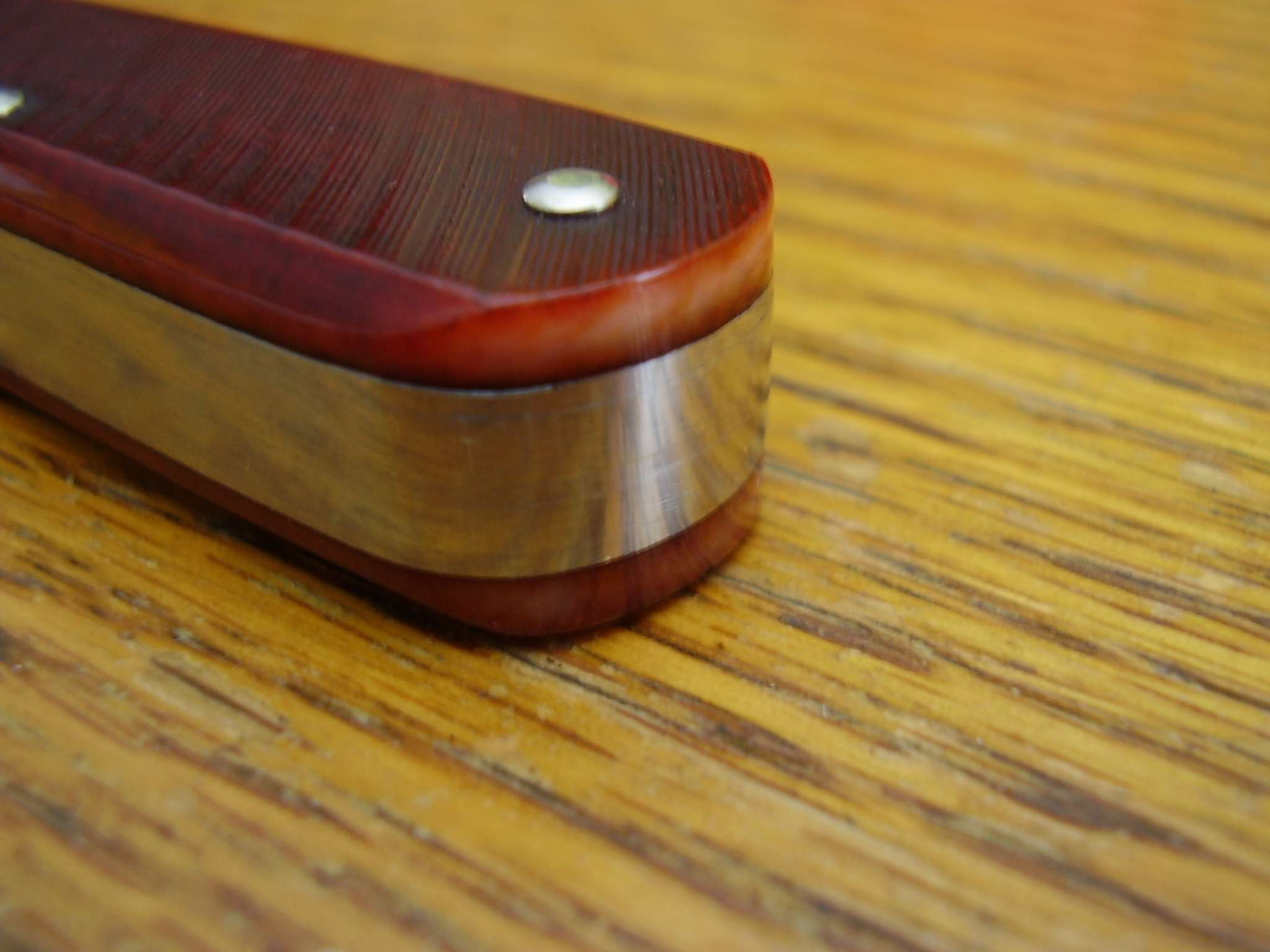

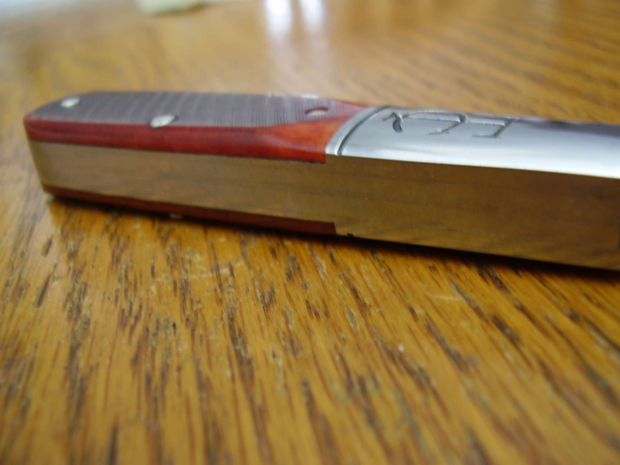

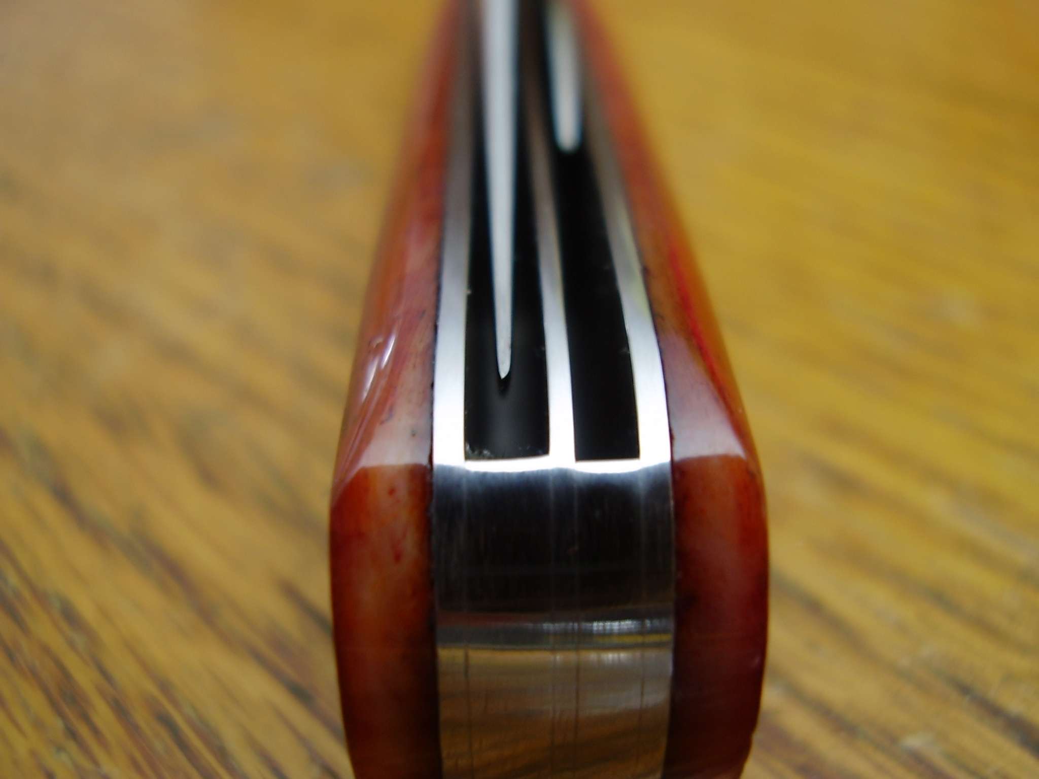

really guys, this is the third time i'm going to post this: There's a critical shortage of top- and bottom-view shots of slipjoints. this is particularly galling with barlows as i'm curious with regard to its supposed "over-engineered" design.
Not 100% sure this is what your looking for hank, something like this:confused:
I have others if this is not what your after;)
