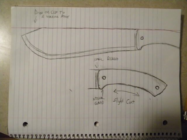

Drew this up quick. It looks a little fatter in the picture than I intended, but you get the general idea. Gradual thickening to a sweet spot, with a well rounded belly, clip or drop to a working point, and a simple, slightly canted handle. Keep the ricasso as close to the handle as possible to maximize useable edge. I think a 'scandchette' grind would be best suited to these PNW woods. Should swing just a tad heavier than a typical latin machete, and for bushwacking the woody, stringy stuff, it should be great. It should also give you good forward weight for chopping, a useable point for drilling, prying, poking and carving, and a flat section to drawknife and baton with.
Wow, thanks PayetteRucker!
You guys are being extremely helpful. . .I'll draw up a pattern this weekend and cut it out of cardboard and modify it to suit; once I'm happy with that I'll bandsaw a section out. I need to get my forge built before I will be able to finish it and there are a few projects in front of the forge, but hopefully I will have this done by the end of February (gotta get those other projects out of the way!). . .
Thanks again!

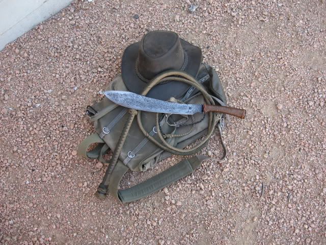

Here's the first one with horse stall matting as a handle that I've ever seen. . .
. . .and the reason I got the horse stall matting I have.
Cool. Best of luck... I love seeing new designs develop, and seeing how they perform. The ideal bushcraft design is more or less the same, but there are so many different environments, it's great to work with machetes.
