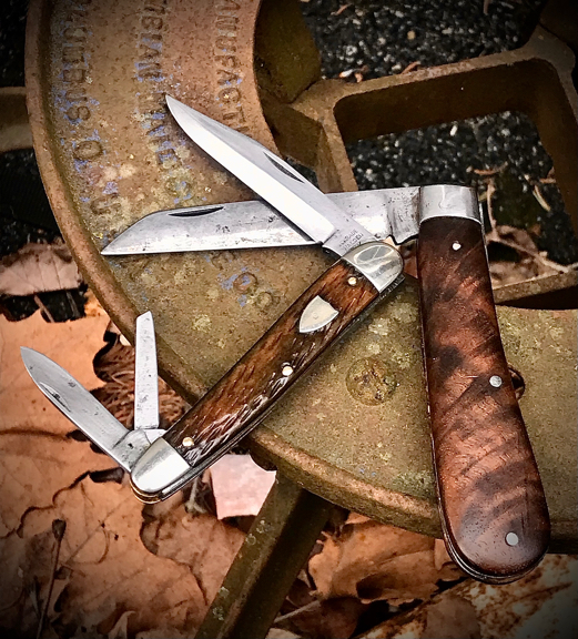

This old whittler has been sitting on my dresser ever since @Jakeywax31 gave it to me at the knife show in March. Words don’t quite cut it Paul, but thank you.
I am not usually one of those ā€œthis came in the mail today, so straight in the pocketā€ kind of guys. This one’s been sitting on top of my dresser getting picked up and inspected every day. Ok, lovingly fondled.
Time to carry it.
Beginning of a love affair…

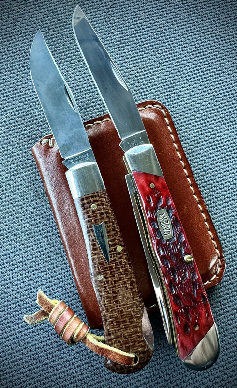

The Schrade doesn't seem to want to leave my pocket lately! It's been a main carry or riding shotgun with an additional knife 😁
I got the GEC from a fellow porch member. The #56 isn't going to be a carry for me, it's going to my brother in law. I got it as a gift for him for becoming a part of our family & to say thanks for him being there for us, he's a great guy & I'm proud for him to be officially apart of our family.
He's a Clemson guy (graduated from there) & a hell of a guitar player so the orange & guitar shield is perfect!
P.S. Thanks again @euroken !
Sounds like my kinda guy!!! We would get along just fine.
Yes and amen to Clemson grad guitar players!!! šŸ…šŸŽø

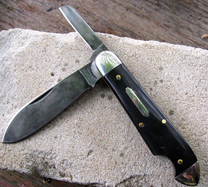

This one is brand new to me, and I’ve been admiring it since getting home from work today. Love the tiny little tip bolsters. Makes the knife feel just a bit classy.
Very fine construction all around and an excellently executed splitback (just look at how nicely that wedge tapers).
I must admit though, I don’t know much about Keen Kutter. I just had to have it when I saw it and have not done much research into it. I’m not really finding much about the maker and I’m a bit stumped as to the age and origin of this one.
REQUESTING ANY HELP IN DATING THIS ONE
I know this may not be the right place but I appreciate any help here or someone pointing me in the right direction.
Here’s the tang stamp on the main blade. Notice the ā€œhornsā€ at the top of the wedge. The stamp reads ā€œE.C. SIMMONS / KEEN / KUTTERā€ and I’m not able to see if there is anything lower on the stamp as it’s covered by the body of the knife in all positions. I can’t really place this specific stamp.
And both smaller blades have a scaled down version of the same stamp on them. Again, note the very small ā€œhornsā€ at the top of the wedge.
Super appreciative of any information anyone may have. My best guess based on the look and construction of the knife is early 1900s, but I’d like to try to get a date range or even narrow it down further?
Editing to add: the back of the main blade has the number 3681T stamped on it.
Alvin Sellens produced a guide to "Keen Kutter Pocket Knives". He went through to every catalog that Keen Kutter ever put out and he summarized them in his book. According to Sellens your knife was in the catalogs from 1905 (the first use of the bar and wedge stamp) up to 1934. The horns at the top of the wedge are usuallly considered to be an indication that the knife was made by Camillus. I don't think that Camillus started making Keen Kutters until after 1927, so I would place your knife as made sometime between 1927 or so and 1934, probably in the 1930s, as @Primble suggested.
Here it is in a 1930 catalog reprint.
