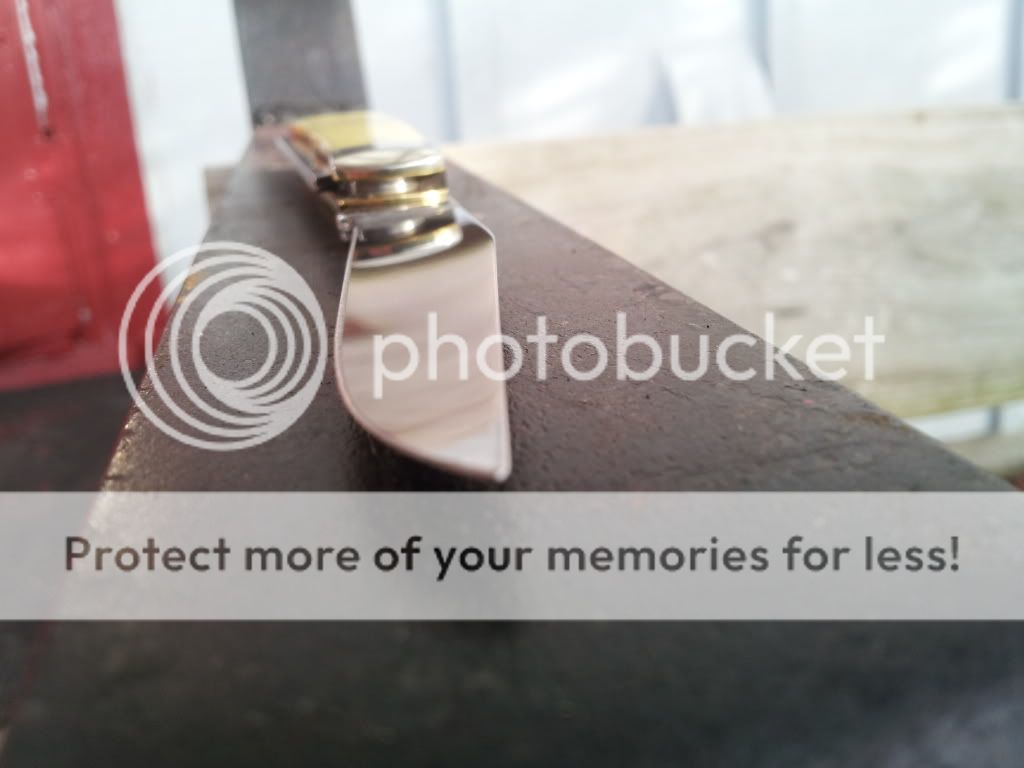

Staying over at ar'lasses this weekend so decided on the nice and slicy Taramundi
So far its helped prepare pasta last night (with bacon and some very ripe tomatoes) and glide through a few clam shells this morning, as I was on lightbulb detail.
Just Wow :thumbup: Is this one of the Case/Bose collaborations?
