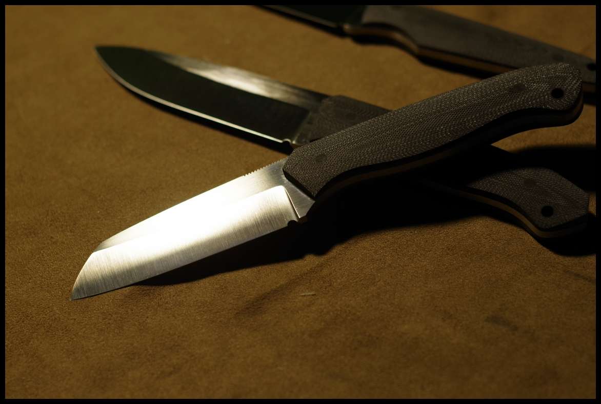

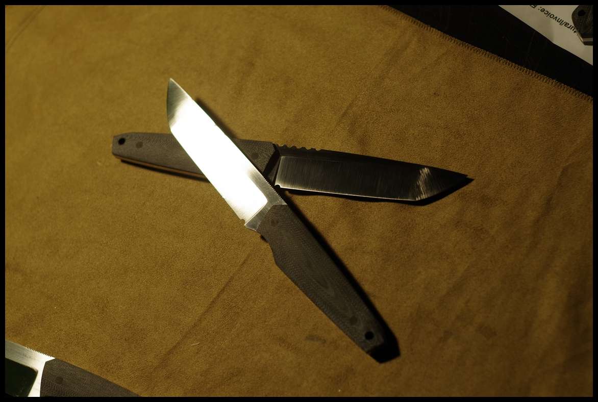

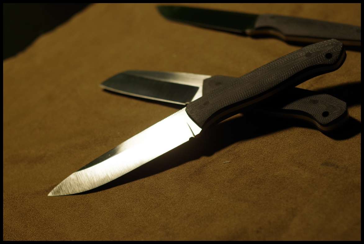

We've been working on a new hunter and a shorter fillet knife. Getting the new designs completed and building all the fixturing for them have kept us very busy. We also had some trouble with our mill, to add a little variety to our schedule :rolleyes: Luckily that's mostly sorted out now and we're on track to have everything ready for our first big show of the year this weekend. After the show the new knives will be available on bladeforums and through our site
The new hunting knife, or "Lynx" as we call it, has a couple new features which we haven't offered on previous models. A hidden lanyard, jimping and scales with liners are the three main ones. We're also changing the way we do sheaths. Still using kydex for the body but we're now making the belt loops out of a very stiff webbing. I want to mention that we got the webbing loop idea from Aaron Gough We really like the webbing for a number of reasons, so thank you Aaron for sharing that info!
Here are a few photos of the new knives. Mostly the Lynx because we haven't cleaned up and assembled any of the fillet yet.

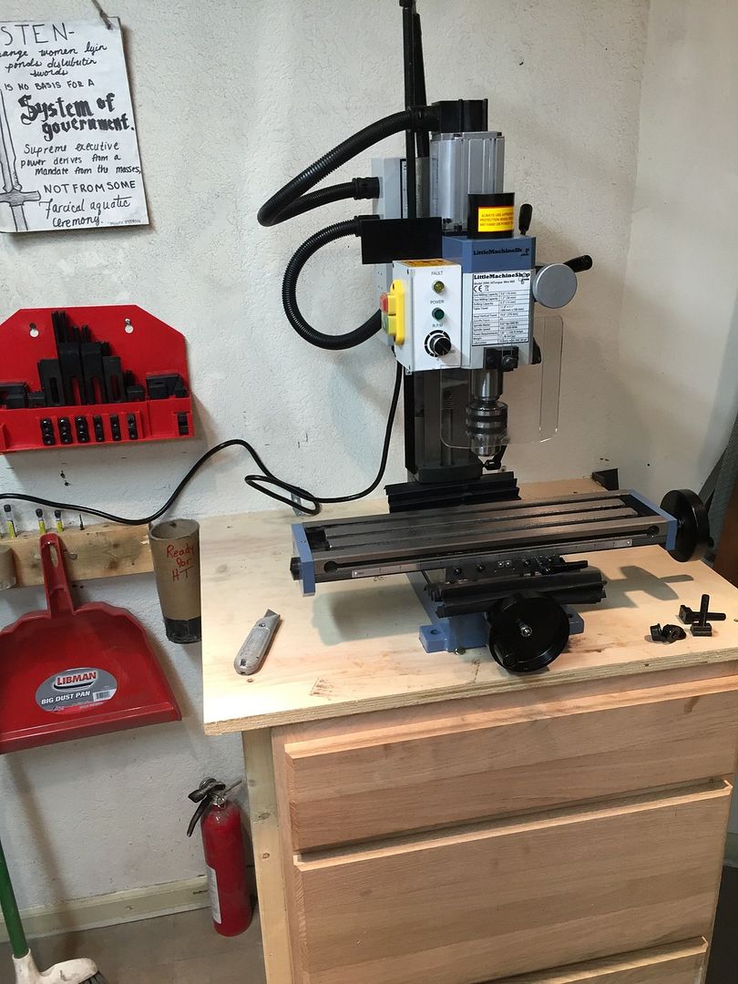

RCETROY, I would be interested in how this mill works out for you. I do not have any experience in operating a mill but I would like to learn how just to mill the slots in guards for my knives. Please share your experience with learning to operate this machine. It looks very cool and might be something I need as well. Good luck. Larry
Larry, I'll try to chronicle my journey into the world of milling. Maybe I'll start a new thread for this.
I got it hoping to mill slots for guards etc, but also to hopefully open up the world of folders some day down the line.

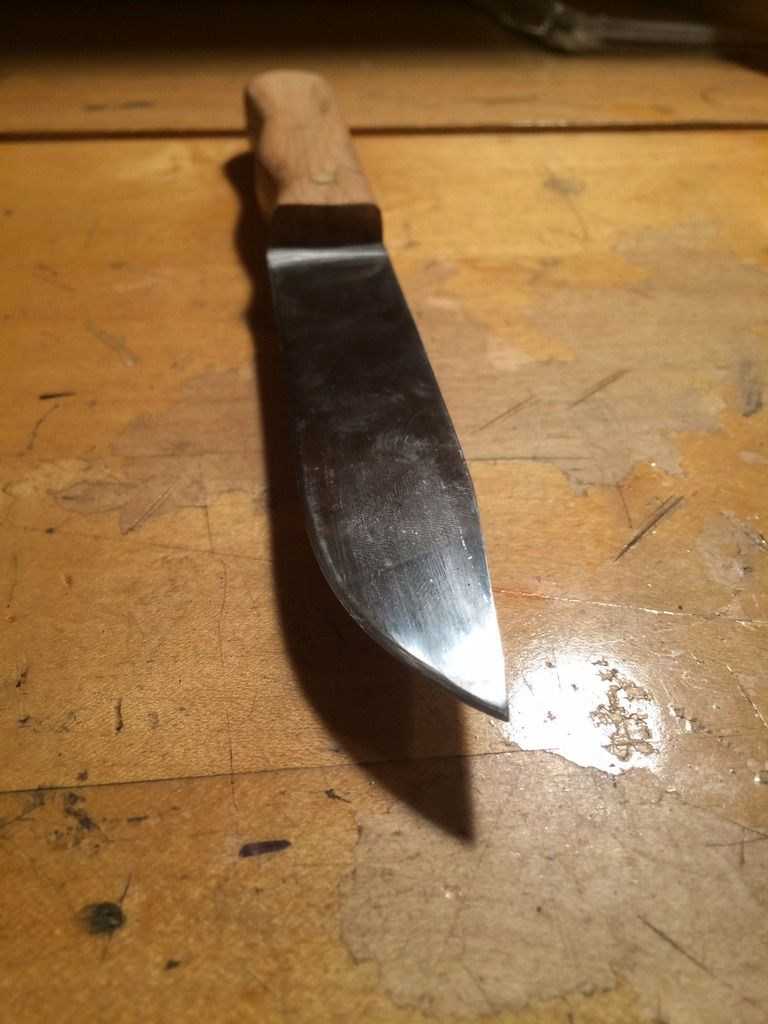

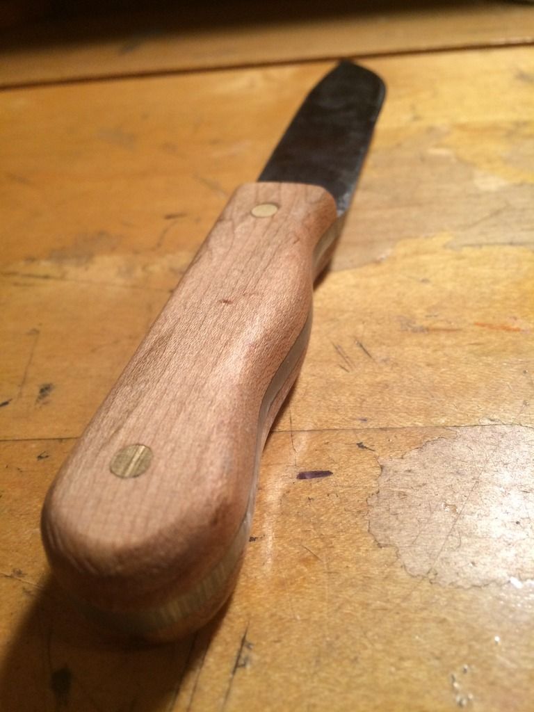

S-guard bowie(s) build:
I like to rough-in the general contours of the handle on the grinder. Then following a series of pencil lines I file away the angles and gradually sneak up on a symmetrical form. I also need to smoothly mate the contours and planes of the antler spacer to the wood handle. The wrought guard and spacer will be polished and etched, so I'm leaving the front of the antler spacer just a bit proud and will round it slightly to make a smooth transition. I still have a bit of work to do on the guards
A bit of 180 sandpaper:
The small one is roughly shaped:
