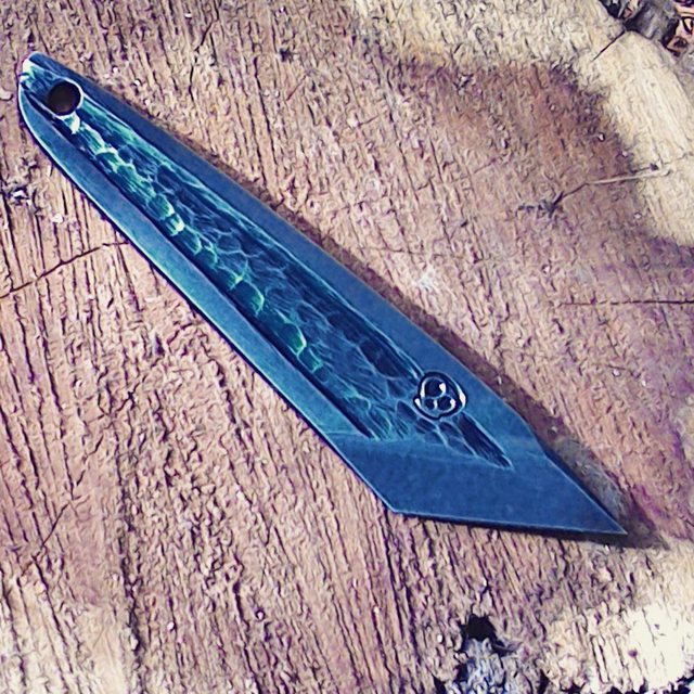

I've been trying out a little bit of carving detail work on my kiridashis. This is a first time for me and this look, so there's a few adjustments I'll need to make for future ones.

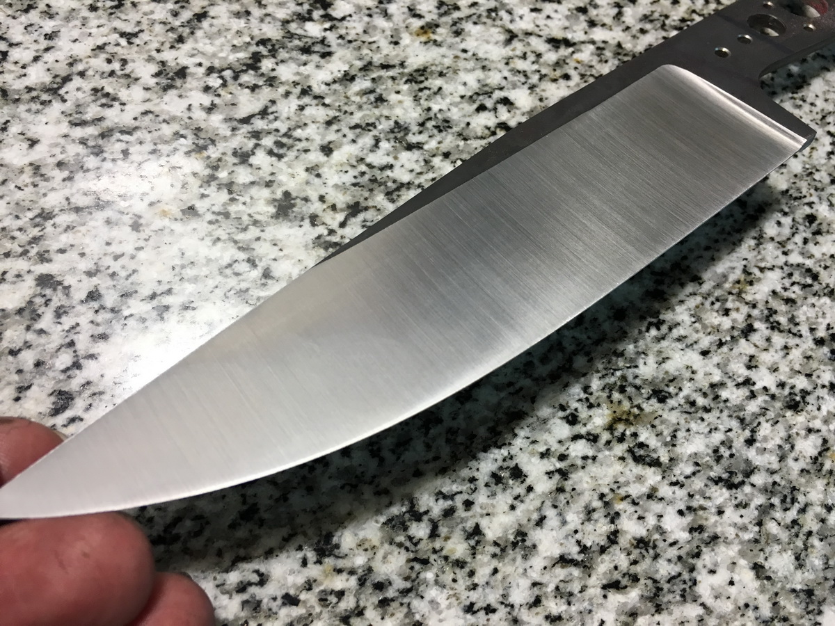

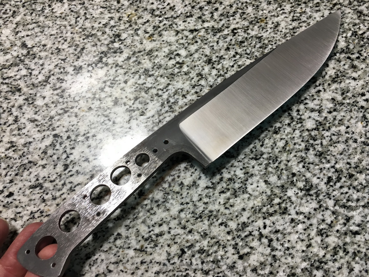

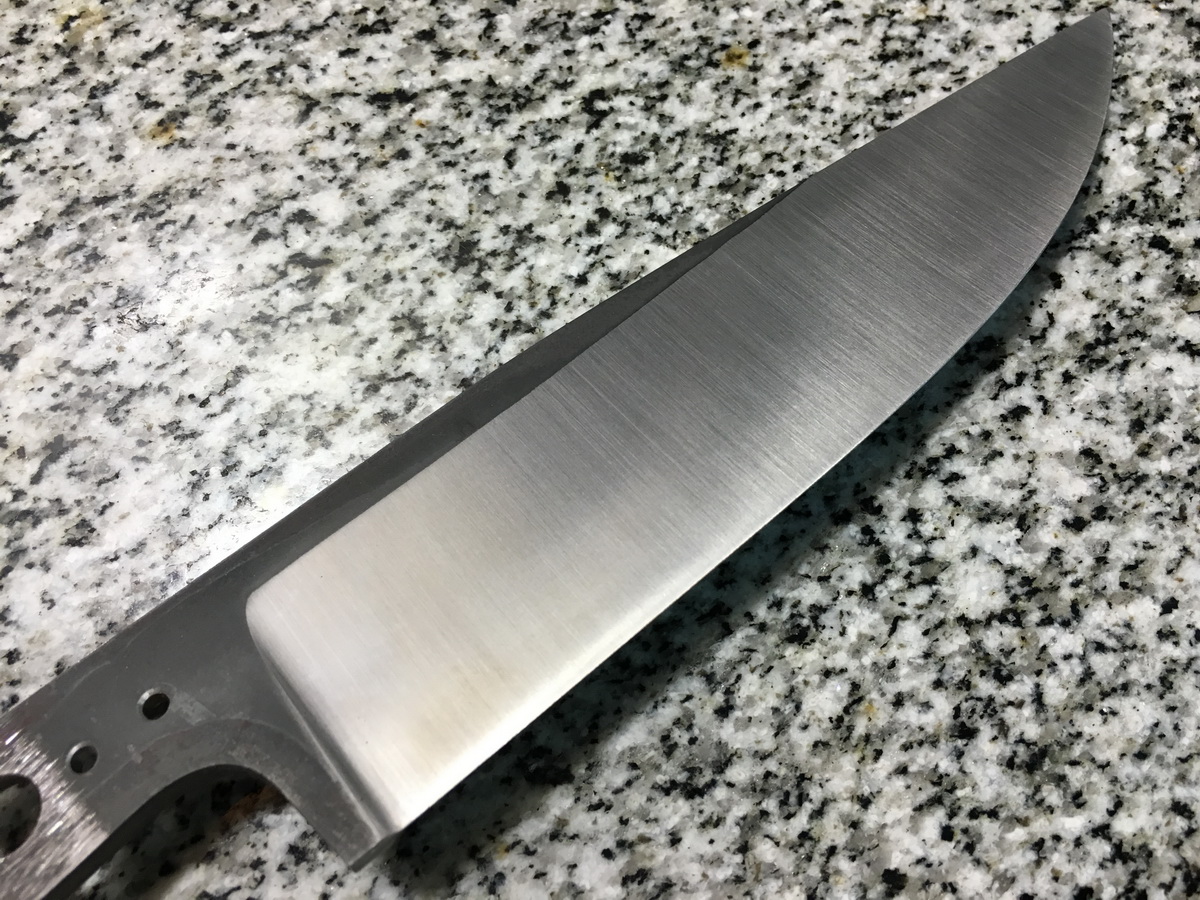

First freehand hollow grind on my new big wheel (430mm / 17") blade thickness is 1/8" still unhardened
I'm happy with the results so far, if you guys have advise on hollow grinds I'm all ears, still learning and adapting.

That looks pretty good Pablo. But what, no pics of the new wheel? :D
