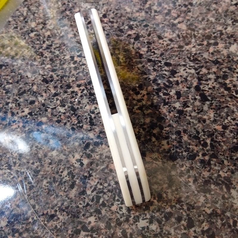

Worked on the scales and back spacer of my first liner lock yesterday. I hope it turns out to be a usable knife. If not, I will try to not repeat my mistakes on the next one.
