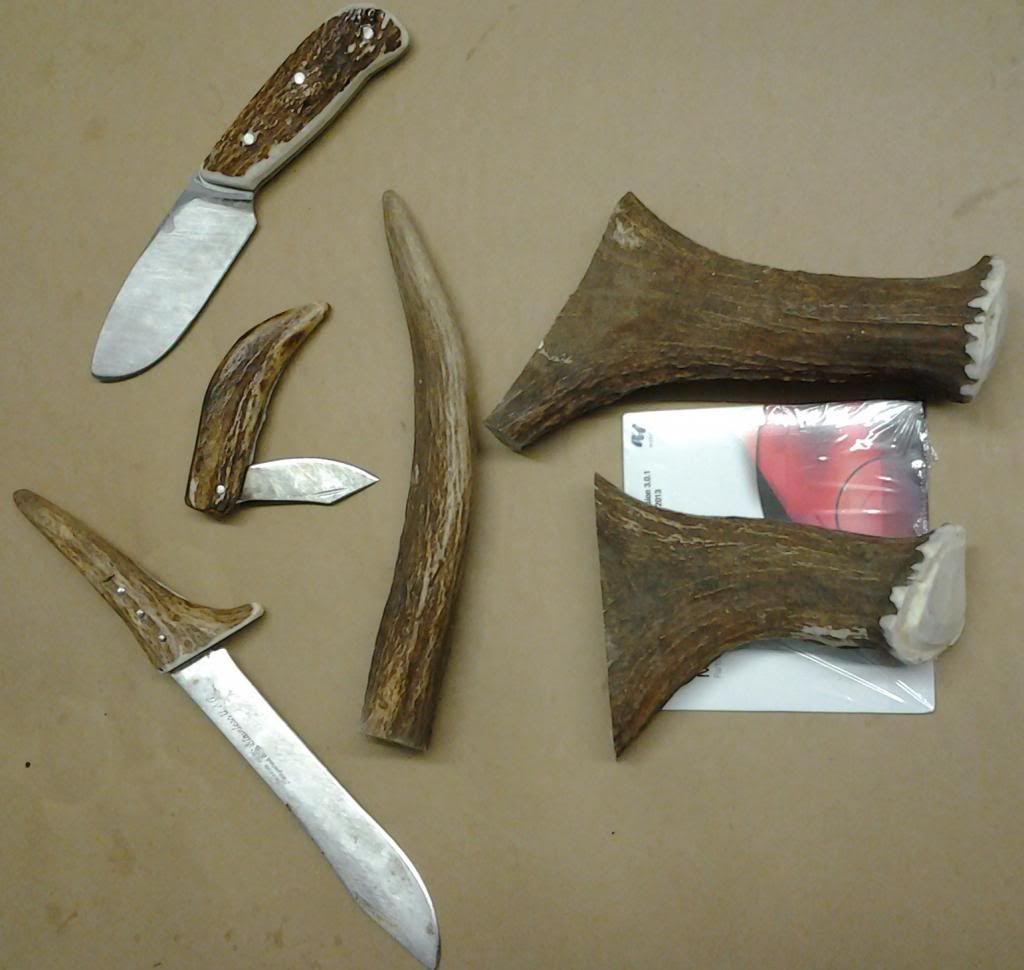

A Study In Moose...
A hunter with moose scales.
A little folder I made tonight from a moose tine and a snapped HT 1084 blade.
A moose tine, waiting for another knife.
A couple of beams which I think will be going on a couple of vintage meat cleavers I am waiting for to come in the mail.
Lastly, a rescue, a knife my boss got from an estate, it says "Geneva Tempered Stainless USA" and has a glyph of two guys working on an anvil. It had a 1/8" chip that I ground out so it is kind of a recurve now but it takes and holds a good edge so I thought it worthy of replacing the badly damaged handle.

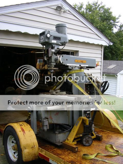

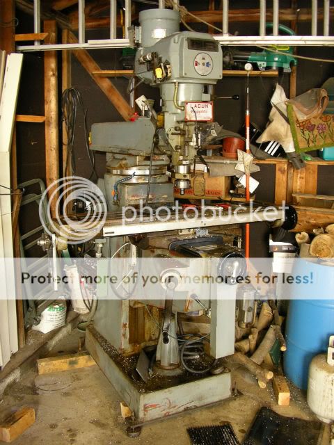

A little over two years ago I bought this mill from a scrap heap for $175. I was able to get my hands on a VFD for free (helps working in the HVAC industry) and wired it up and ran the mill for the first time this past weekend. Next step is to get a keyless chuck, some bits, saws, and start making some folders. :D

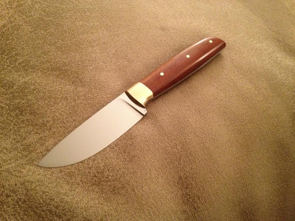

I finished this one a few days ago. It's my fifth if you include a couple of marking knives I made for myself to use in the wood shop:

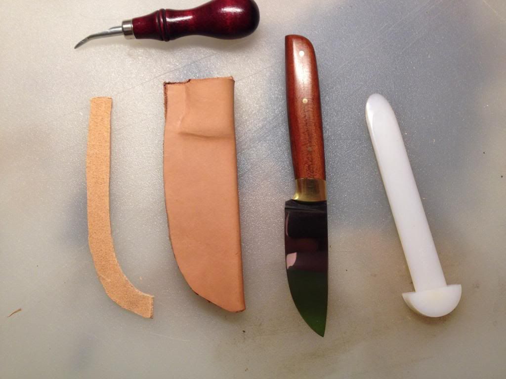

Now I've started making a pouch sheath:

I should have listed a few specs, its 1/8" thick 1095 that I HT'd myself using a rather crude fish cooker forge, a digital high temp thermometer and a muffle pipe. It has brass bolsters and pins but I'm not positive what sort of wood the scales are. A retired preacher friend of mine who's since passed on gave my dad and I that piece of wood some years ago and he said it's "Ironwood". I've asked around and done a little research but I'm not convinced of what the wood really is.
My dad asked me to use some of this wood for knife scales one day so here it is.

Nice! It looks very clean mate, great attention to detail for sure! I guess that part translates well from woodworking!

That's a deal of a lifetime.

Mike- that is the most insane deal on a mill I've ever heard of. Is that a 9X49? So are you going to use it as a manual mill? Very cool!

Nick - It is a 9x48. I am going to use it as a manual; I took all of the CNC scraps off. It is missing a few things but is tight and the drivetrain is in good shape.

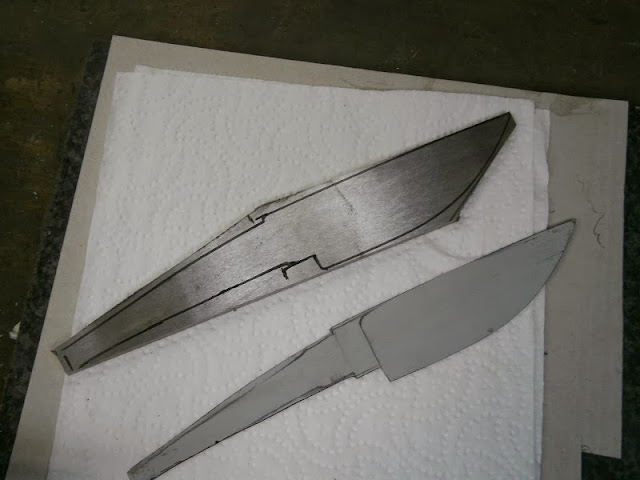

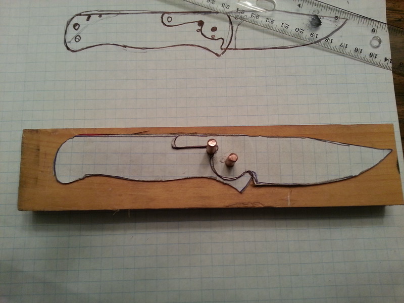

Here are some photos of a knife I just started.
