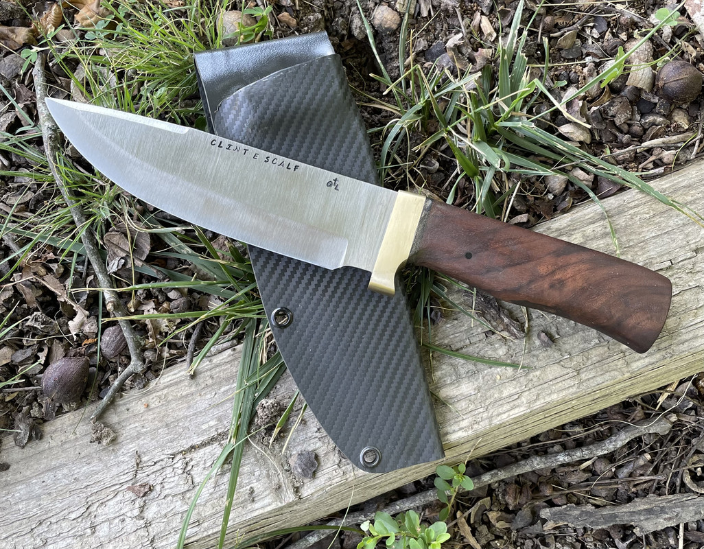

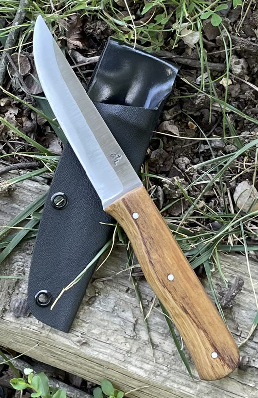

while I'm not really digging the general shape of this sheath, (it's close but not quite there) its function makes me very happy. I'm always looking to create sheaths that have an easy, quiet draw, that also retain the knife well enough that it doesn't rattle around or fall out willy nilly. This one works as perfectly as any sheath I've ever made, and better than most.
Now I can start thinking about how I want to design the carry system...
