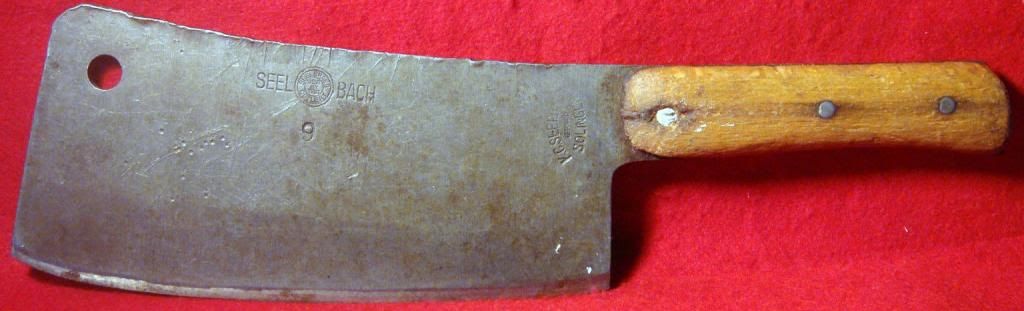

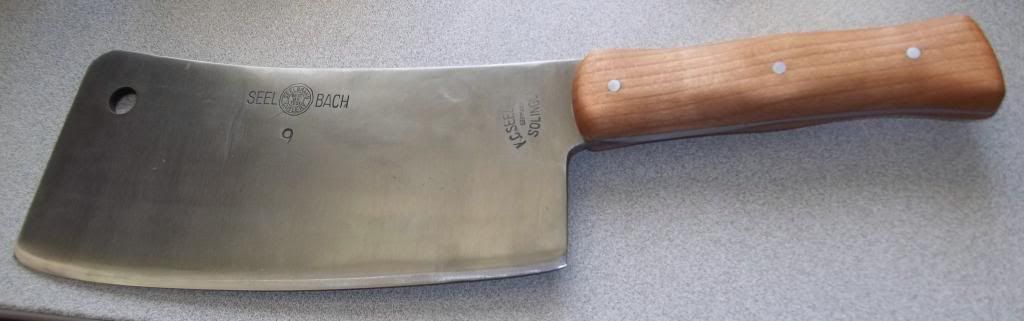

Before and after pics of another rescue.
I bought this off of the great auction site. Had to buy from the limited supply of items listed in canada; tried several times to get nicer shape ones from US but it seems nobody wants to send meat cleavers to Canada.
This was pretty beat up, looked like somebody was using it for target practice with a bb gun and some sort of bladed tool. I managed to clean it up pretty well but there are a few deeper marks from the cuts that I am fine with leaving in so I don't mis-shape the blade too much or remove the makers marks.

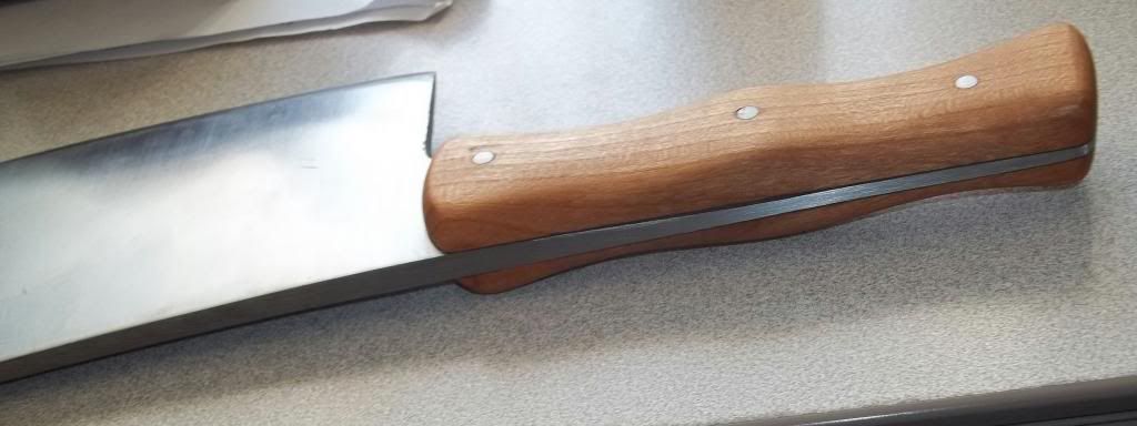

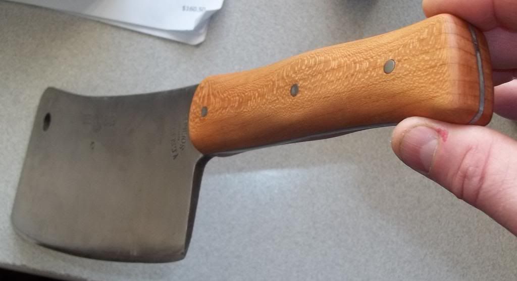

The tang was slightly overdrawn so there is a gap, it was also bent, I straightened it but did not try to grind it flat. I came into some nice chunks of hard wood, I believe this to be walnut... with tung oil.
It looks like there is an actual open gap between the scale in the pic but it is filled solid with epoxy mixed with a bit of sawdust. Over about 3 hours I kept drizzling epoxy into the top gap until the epoxy was setting up and didn't run out the bottom anymore then finally mixed a bit of sawdust into it and pushed it into the gap.

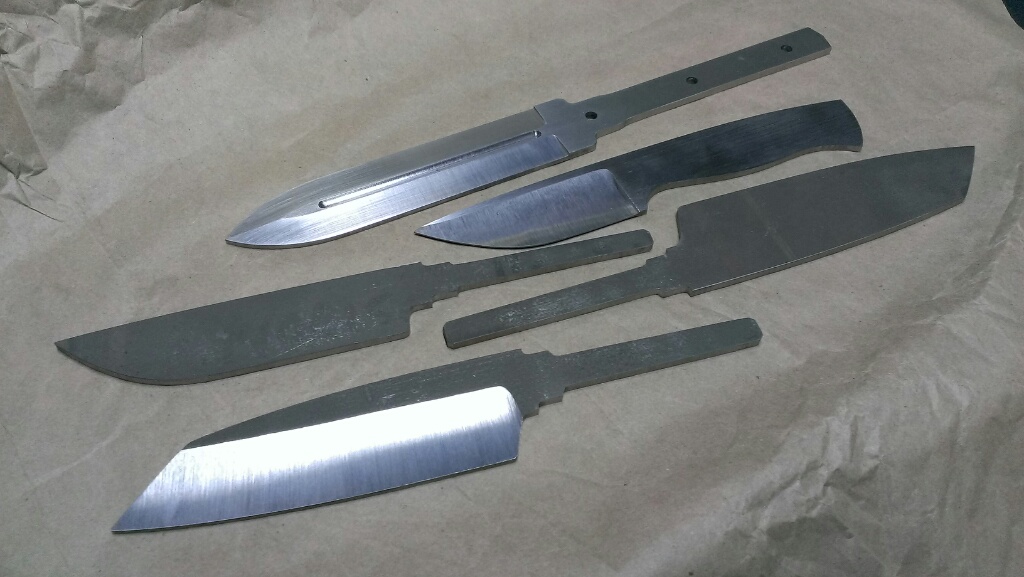

This is my first batch of S35VN, and my first dagger, first fuller, first full hollow grind, and first tapered tang :D
Goin a little crazy on this one.
Disclaimer: all of these are in various stages of finishing. They only one that is actually finished and ready for ht is the dagger.
Bottom looks like it would be great in the kitchen. Have you thought about using a small wheel to take little bites like is often seen on Santoku knives? That might be a fun variant. Every thing is looking really good.
Yeah, I made the original with the intention of it being a "non-hunter hunter". A lot of people, myself included, do a lot more camp cooking than hunting, but my most used camp knife was a cheap little santoku that lives in my mess box, and wasn't really good for anything else. I thought it would be nice to carry one knife that would handle just about anything I needed to do on most trips.
My original intention was to pair this with a small paring knife in a double sheath as a set. Either way, I got good response after the first was posted for sale, and have a couple more in addition to the above to make. They ended up almost taking over this bar of S35, but I would have gone nuts making a whole bar of nothing but those. :p
Edit: for the q about the scallops, I actually have a little jig I thought up, it's on the list of things to try. It's actually intended for another knife I plan on making, the "best ever cheese knife". :)
