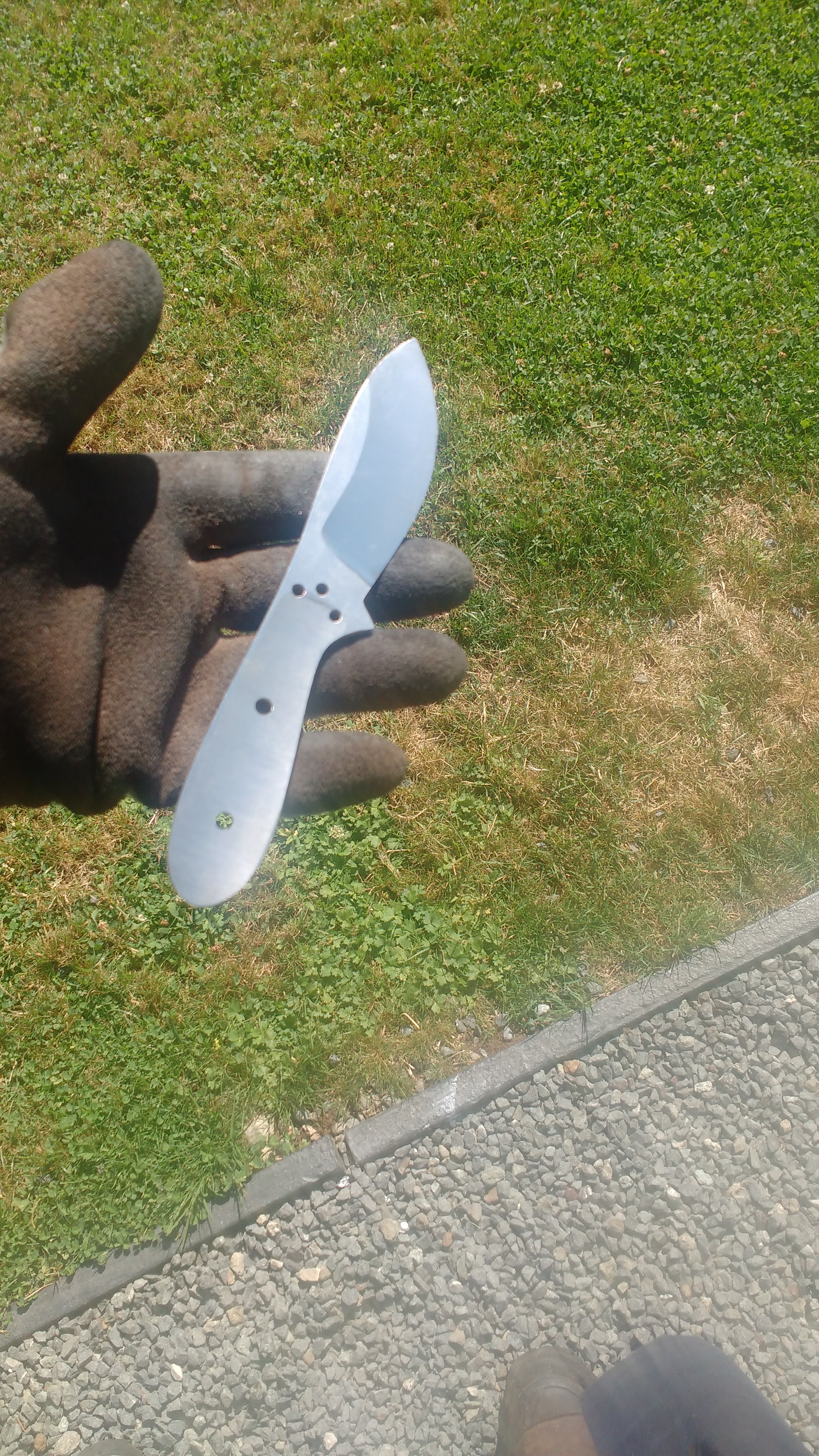

Thanks, I find that the shape of the tang really helps you get the hang of it. A tang shaped like that one almost makes you "coke bottle" it. A small wheel really helps but I started with just a slack belt.
When you tang has a belly and butt like this one, I start carving out material on the bottom between the butt and belly then I move up and carve out some on the front of the belly. I don't touch anything else until I have some nice indents going, then I start rounding everything else out with a slack 20170810_123011.jpg 20170605_202509.jpg belt.
When you tang has a belly and butt like this one, I start carving out material on the bottom between the butt and belly then I move up and carve out some on the front of the belly. I don't touch anything else until I have some nice indents going, then I start rounding everything else out with a slack View attachment 749135 View attachment 749136 belt.
