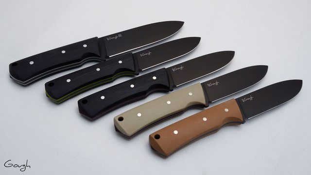

Just finished my first ever batch of knives! This batch has taken a really long time (3 months!) as I've been having to iron out processes and such as I went along. Many tools and jigs were made, and the next batch will definitely go significantly faster! I got the engraving, sharpening and photos done this afternoon...
These are all A2 @ ~62HRC, G10 handles, graphite black Cerakote, and kydex sheaths for the lot!

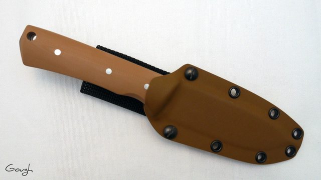

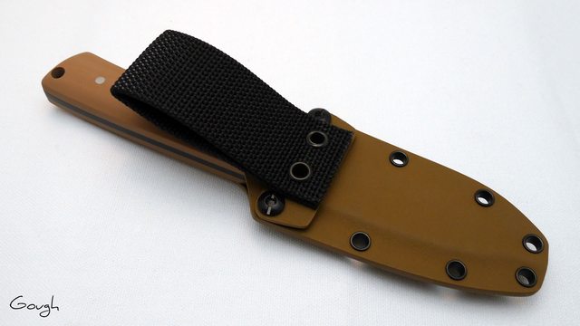

I'm especially pleased with how the sheaths and belt loops came out! It took a lot of mucking about to get the right kind of webbing, and work out how to attach it in an ambidextrous and low-profile way, but I'm very happy with the result!

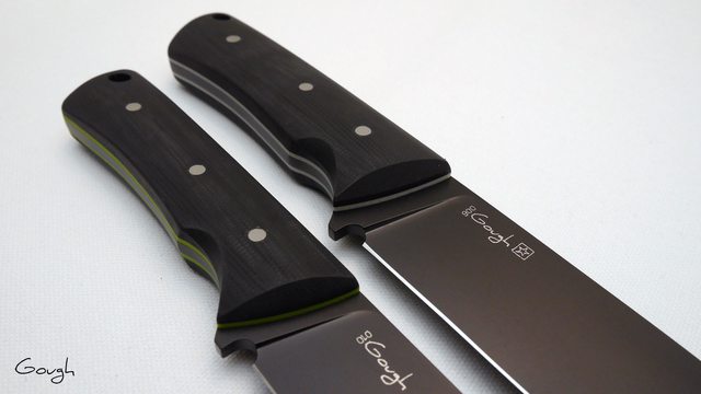

I accidentally put the same serial number on two of the knives, kicked myself big-time after doing that, as there's no way it can be un-done! The engraving was done on a CNC router, using a carbide v-scoring bit running at 16K RPM. I tried having some test blades laser etched, but it looked much fuzzier at the edges than the mechanical engraving did!

Your logo looks killer. Thats about as clean as it gets. I've never even thought about using a router to do logos. Great idea!

Thanks mate!
I tried it initially because that was really the only way I could do it (I had a small semi-homebrewed CNC router in the shop), I was surprised when I first tried it that it worked so well! I think it's less useful on uncoated blades as the contrast isn't there... To try to fix that issue I'm going to try applying a resist to the blade, engraving through it, and then etching with Ferric Chloride and see how that goes. I will definitely report back on that front!

where did you get the black Chicago screws at. are they 1/4

The chicago screws are from KnifeKits.com, they have a pretty good range actually. The ones I'm using are called 'slotted posts', basically the female half of a chicago screw that has been machined with a screwdriver slot (usually only the male side has a screwdriver slot). I like those for the sheaths because it means my customers can put loctite on the screws and still be able to get them back off if they want... if you put loctite on a regular chicago screw I can't imagine you'd ever be able to get it apart again!
ahh ty so much. I wasn't aware of them I thought you had machined them or something. ill head over and check them out. just ordered from jantz again. all they have are nickel and brass.
Knifekits is the best place I've found for Kydex sheath supplies... They have a really wide range of stuff!
