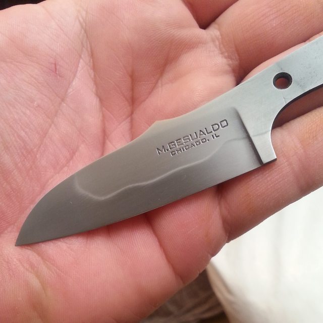

Decided to give the whole hamon thing a shot. Had no idea what I was doing, so there isn't much of any activity (or I lack the skills to get it to show), but there's a lot of contrast so I like it anyways :)

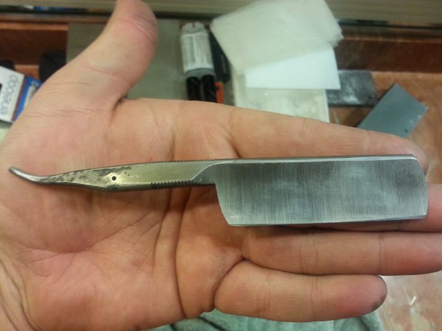

Also on a little bit of a straight razor kick. This one needs major finishing work, but I figured I'd sharpen it up and give it a little test run. Happy to say, my face is still fully intact (minus parts of my beard).
My first hamon looked like a smudge on the blade. Each one got better with practice. It takes years to get good at it. Keep going!!!!

@Weebus- a double-shot of questions please...What steel did you choose for the razor and is that a 10" hollow? Looks to be a 1.5 in wide blade... How thick? Looks great!

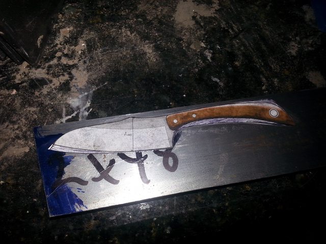

Thanks! That one was actually my contribution towards a thing on another website. They held a "best knife design" contest, a few of the knifemakers over there agreed to turn the winning designs into real knives, just for fun :P I had to make some changes to make it a more usable knife... and since it wasn't my own design, I figured I'd have some fun with it (hamon, etc).
I'm thinking blackwood with a copper liner will look slick for it. I've been meaning to do that combination on something for a while, but always end up going another route when I get to that point.
Here is what the design from the contest looked like with my adjustments in uber high tech pen shading:
I'm excited to try another after this. I kind of just slapped some furnace cement on the spine and hoped it would do something. Didn't expect much at all. I followed Ryan W's method of bringing it out, and it worked quite well! Makes me wish I put some more thought into the clay coating, though...
I used 52100, about 0.270" thick at the spine, ground on an 8" wheel (all I have haha). It's a big one... width is just under 1", or 8/8 as the razor folks say, about 2.8" long if I remember correctly. As part of the angle calculations, I did the math to see where the distance between tangent circles 8" wheels would be equal to my stock thickness... came out to be something like 0.98", so I went with that for the width (not sure if my description makes sense... I'm an engineer, not a writer) :P Ordering up some smaller wheels so I can do more "full" hollows. Really enjoying the razors, as they provide an interesting challenge :)

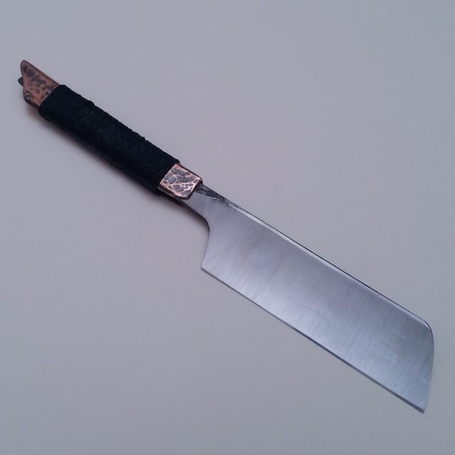

Finishing up a Kwaiken and a Kiradashi. Waiting for the wraps to cure 100%

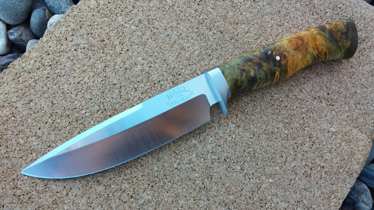

Brindle Hunter #2, this was a commission I finished during the week.
