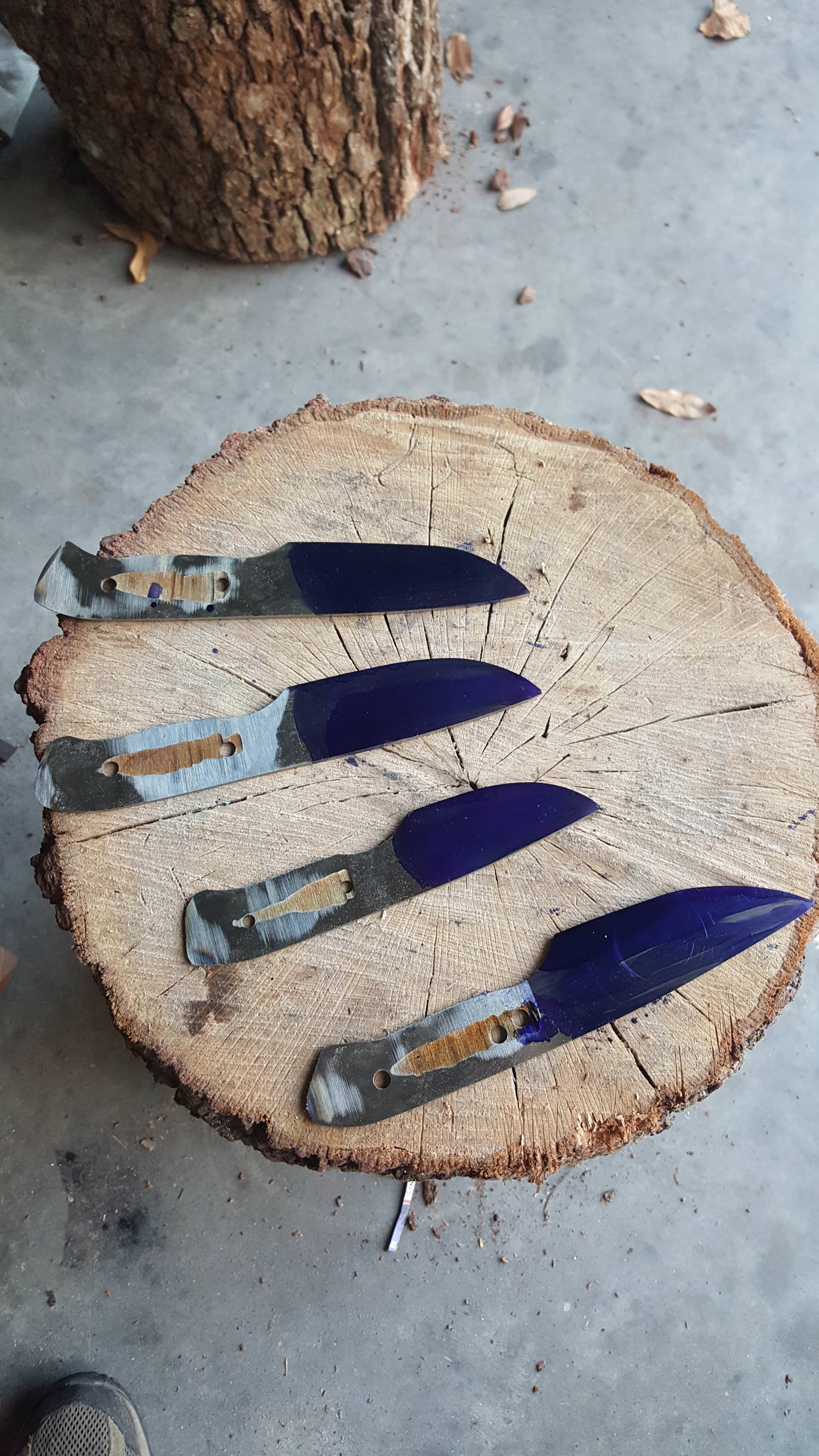

I'm looking to finish the build on my 2BF and heat treat my first knife this weekend . This step has been my biggest concern all along and I have to admit, I'm a little worried that my forge won't get hot enough or that I'll botch the quench temp or something. I'm also worried that I put too thin an edge on my knife and that it will warp or crack. No specific questions right now, just wondering if anyone has any tips or tricks or common first-timer's mistakes I should avoid.
And I have to say, shaping knives is a lot more fun than shaping fire bricks...

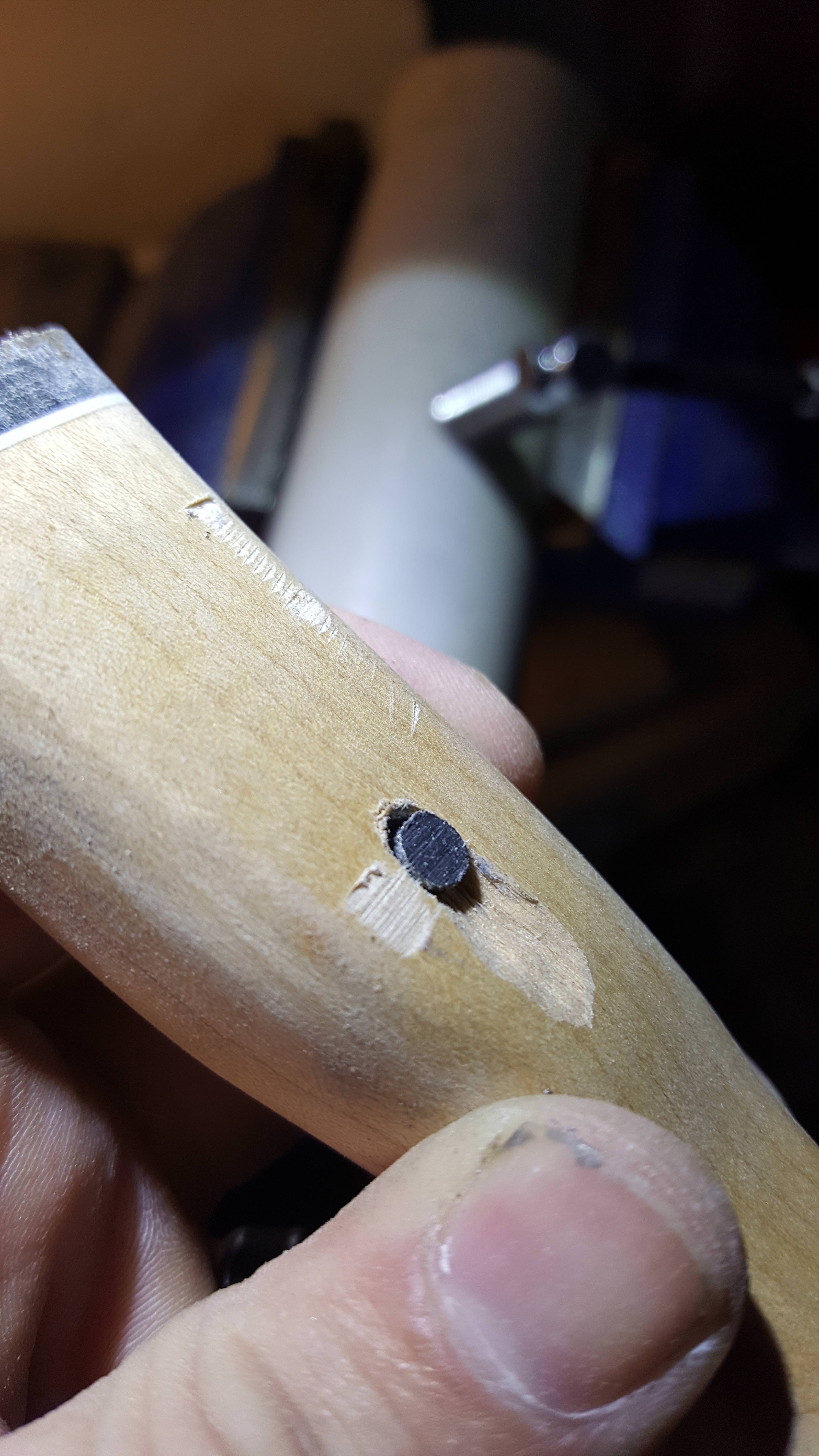

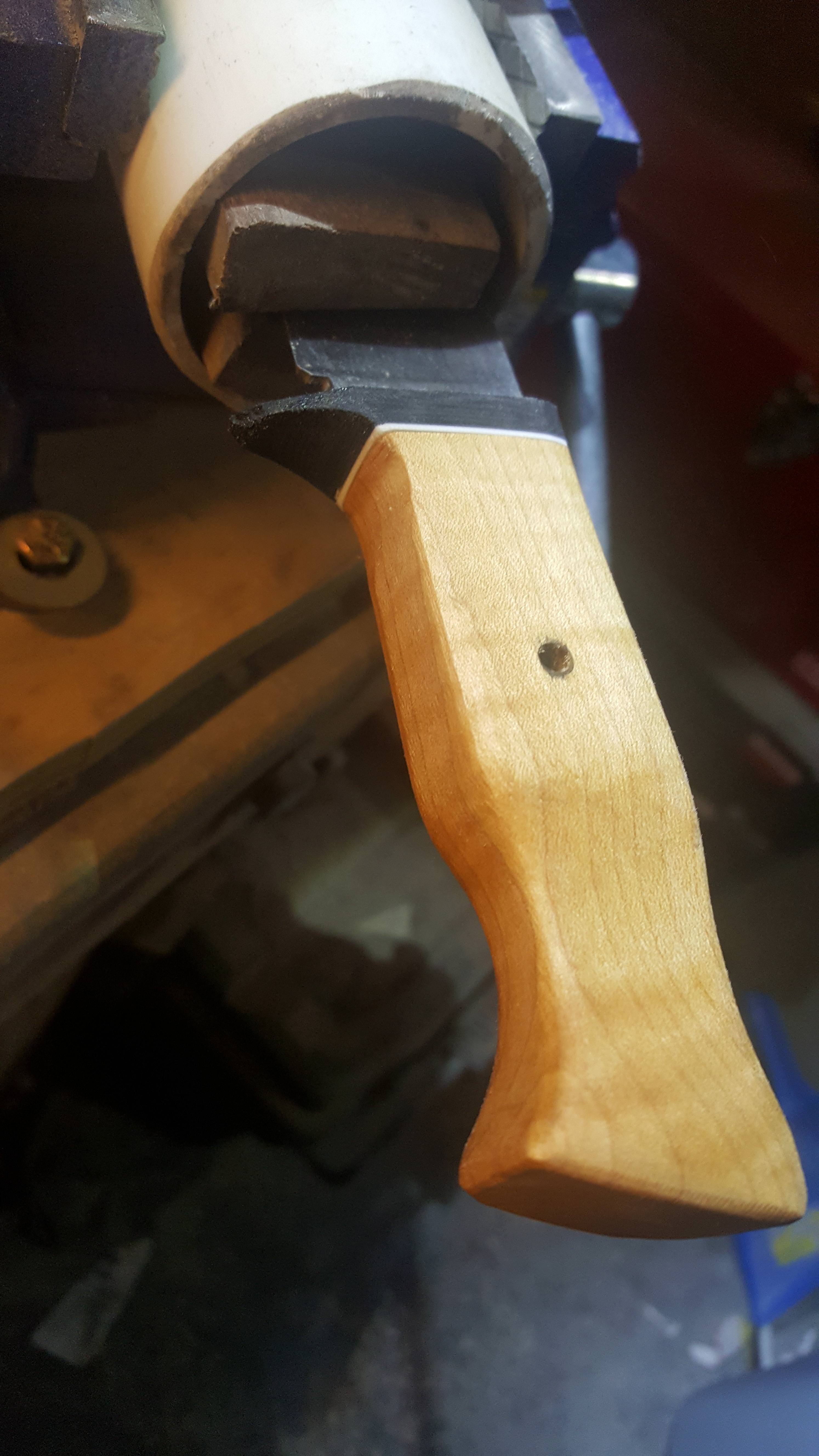

Valnut, what happened to your handle is the reason why I try to always drill holes before shaping a handle.
If I need to drill a hole trough material and there's no extra material on the other side that gets removed afterwards, I try and have some backing there to prefent tearout
Well the hole was drilled but for some reason the hole in the tang and the handle were not lining up. All is well I tested it and learned what tweaks I need for ht on a "batch" I'm working on now.

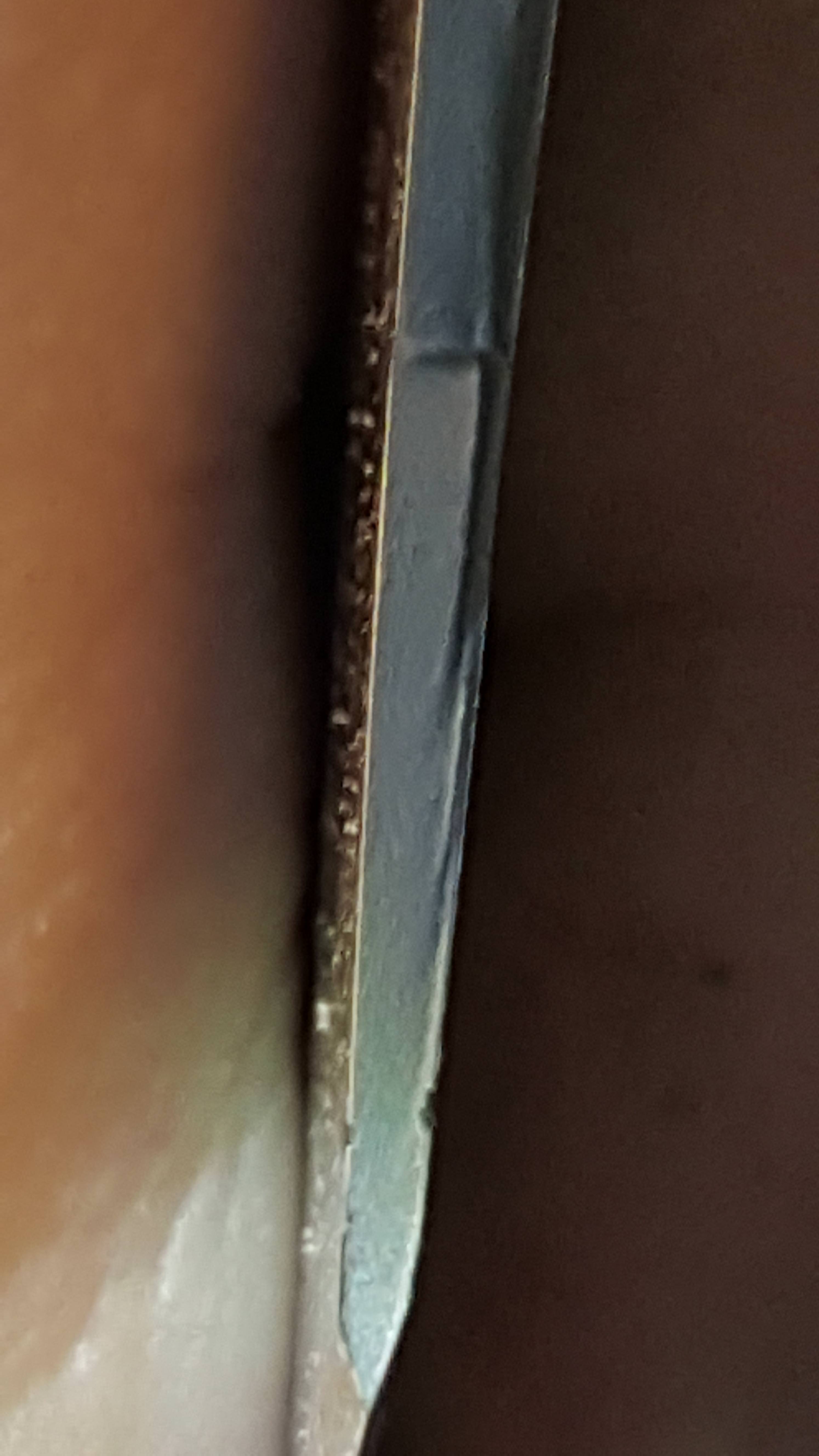

I am pretty happy with the build. This is my first time working with a wood material, so some things I had to experiment with. How do you guys get a nice low grit (220g) finish on the spine, but keep the scales at a higher grit?
I am also having a hard time buffing the material. I have taken it to 1500 grit, and then to a buffer with green compound on it. Low speed and light pressure, but I can't seem to get that pop that I want.
Any advice?
2017-12-23 03.01.33 1.jpg 2017-12-23 03.02.22 1.jpg 2017-12-23 03.03.28 1.jpg 2017-12-23 03.04.08 1.jpg
Either remove the scales and then finish the spine or very carefully whap sandpaper around something thin and sturdy and have a go over the steel only. Go one direction only
