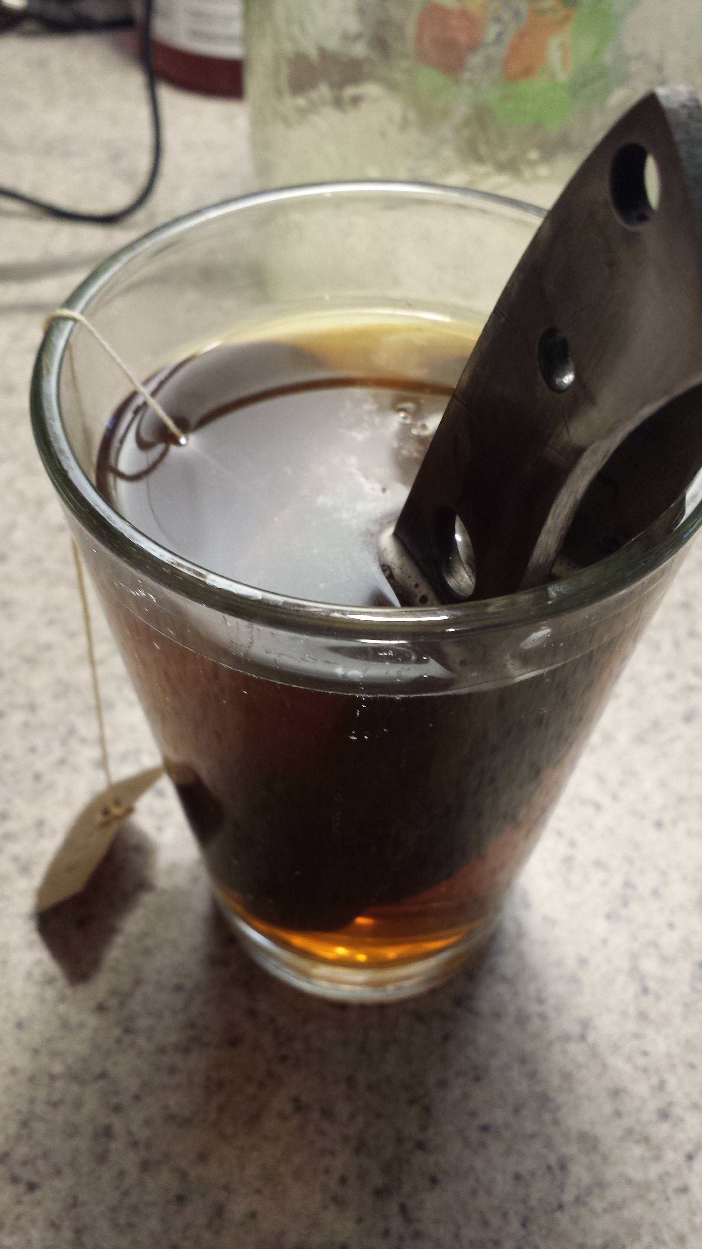

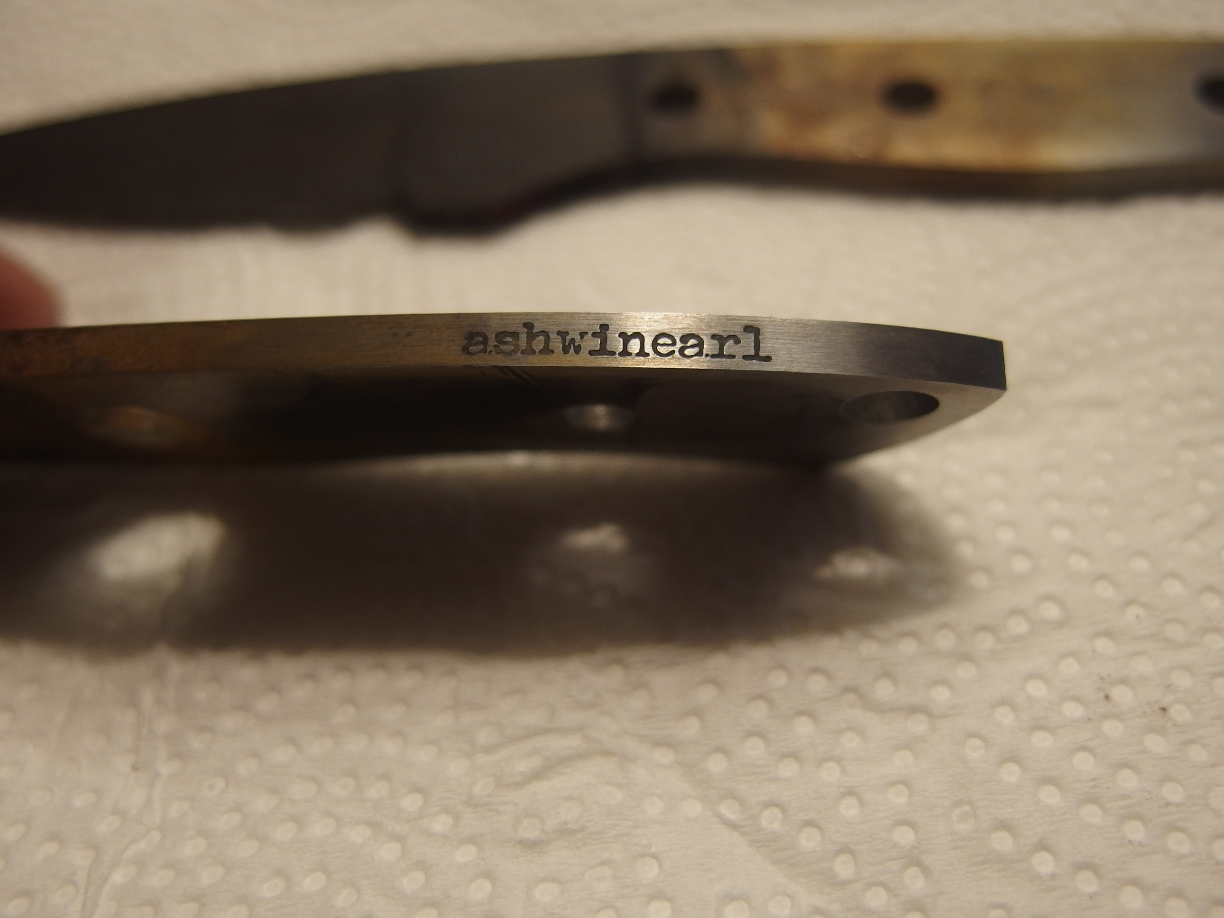

I got my etching machine and have been practicing marking. My first try was a big black blob. With carbon steels, I am interested in patina approaches. There was a kitchen knife forum post discussing Vinegar and black tea to achieve very dark patina. I tried some with green tea and got the dull grey typical of vinegar, then tried some black tea. The black tea ones did come out much darker. They are all splotchy after wiping them down. This is with O1 heat treated by JT.
I read about wiping with gritless silver polish between dips to even the finish out, but didn't have any. I tried automotive compound and polish and didn't seem to do anything in terms of smoothing out splotches.

I experimented with vinegar patinas all day Sunday. The house still stinks.
Regarding the splotches make sure the blades are clean with soap and hot water before starting. Then clean them again. Don't even think about touching the metal you're treating even if you're wearing gloves. When you take the blade out of the vinegar it should go straight to running water . These things greatly improved my vinegar patina results.
Rubbing compound evens out the finish nicely too.

I'd like to see some of the results of your testing. What type of steel?

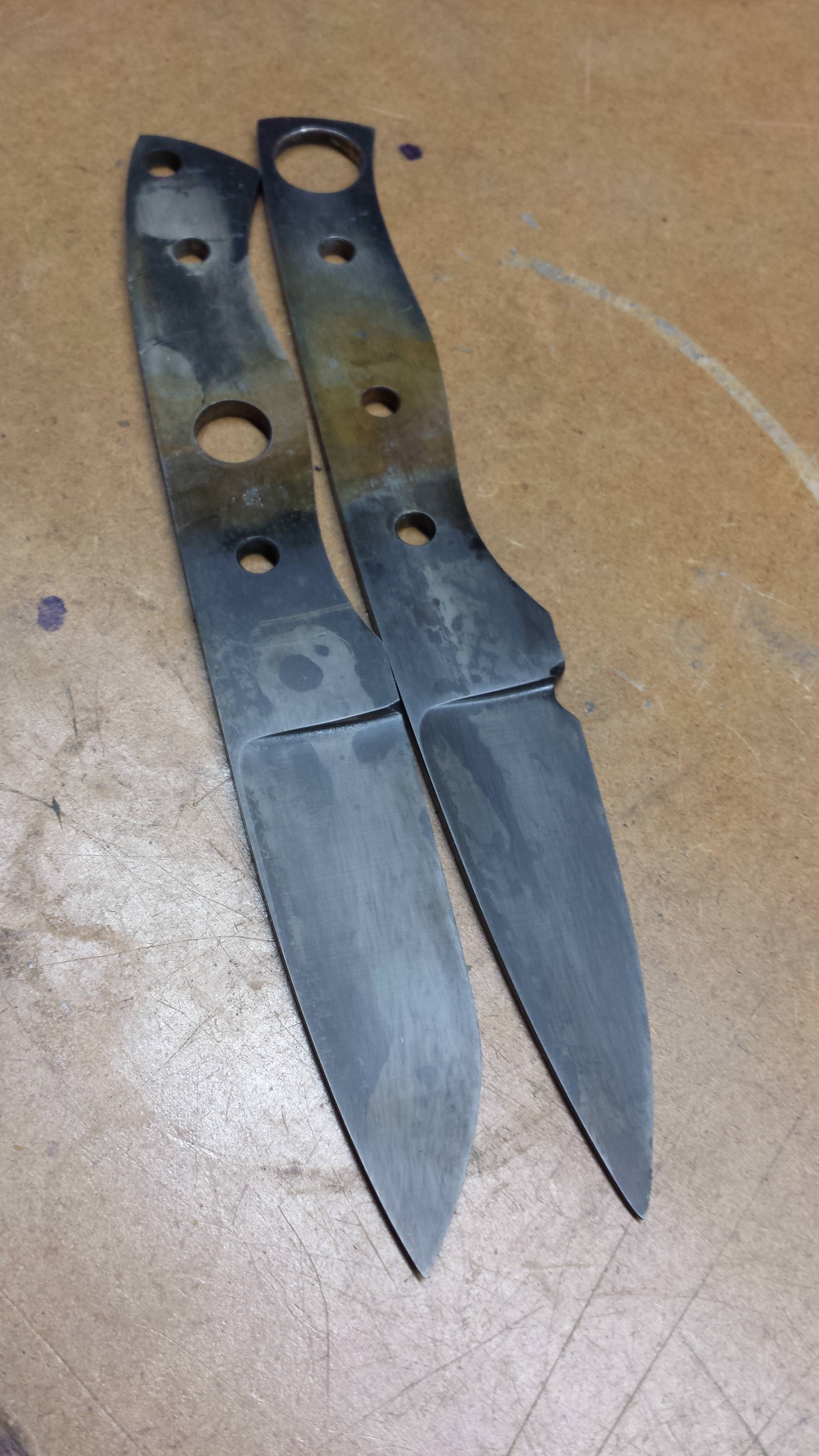

It's 1080 steel. I didn't take pics of the failures but I took some of the finish I'm happy with.

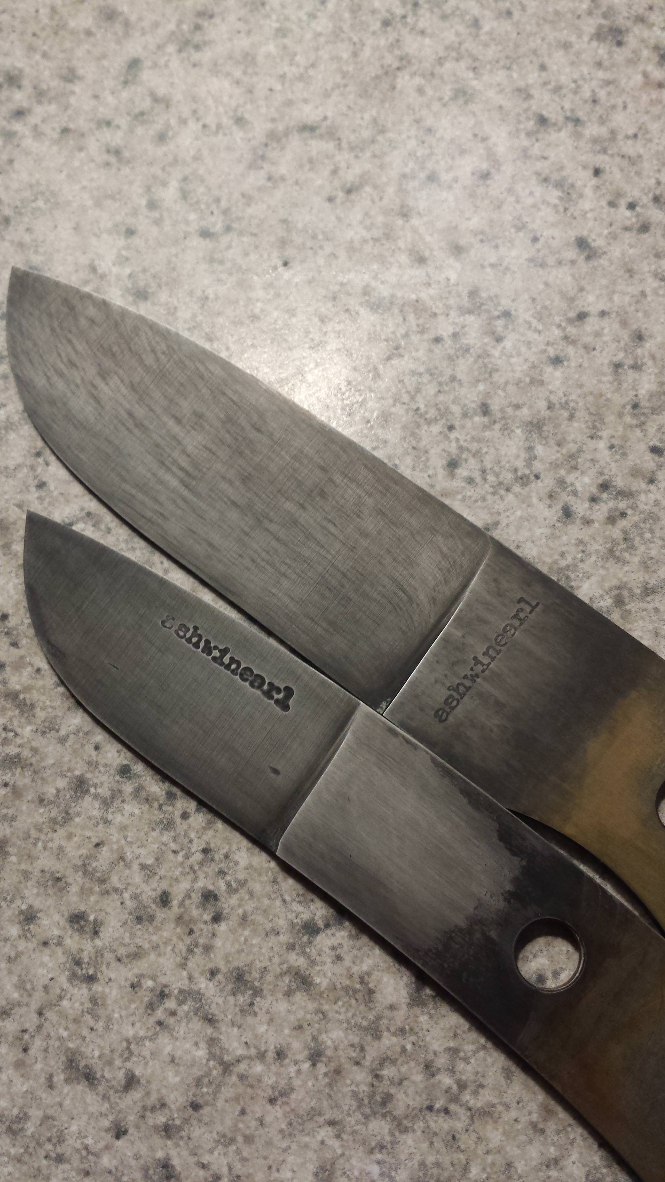

The blade was sanded to 400, HT, sanded to 600, and bead blasted. Before the vinegar bath I hit it with brake cleaner, washed it with soap and scalding hot water 2x, gloves on, gloves washed, blade washed with gloves on, then placed into a mixture of half white vinegar/half water that was just under boiling. I let the blade sit in the mixture for about 30 seconds. I took it out of the bath, gloves still on, pinching in the middle of the handle with 2 fingers and directly under running cold water. It was slightly splotchy so I used automotive rubbing compound with paper towels until I got an even finish. It took away quite a bit of the darkness but made it perfectly even so I consider that an even trade off.
The blade on top is a different design but is exactly as the experimental blade was prior to bead blasting.
The bottom blade is getting canvas micarta scales. I'd like to finish the scales and dunk the whole assembly into the vinegar bath. Does anyone have any experience with that?
