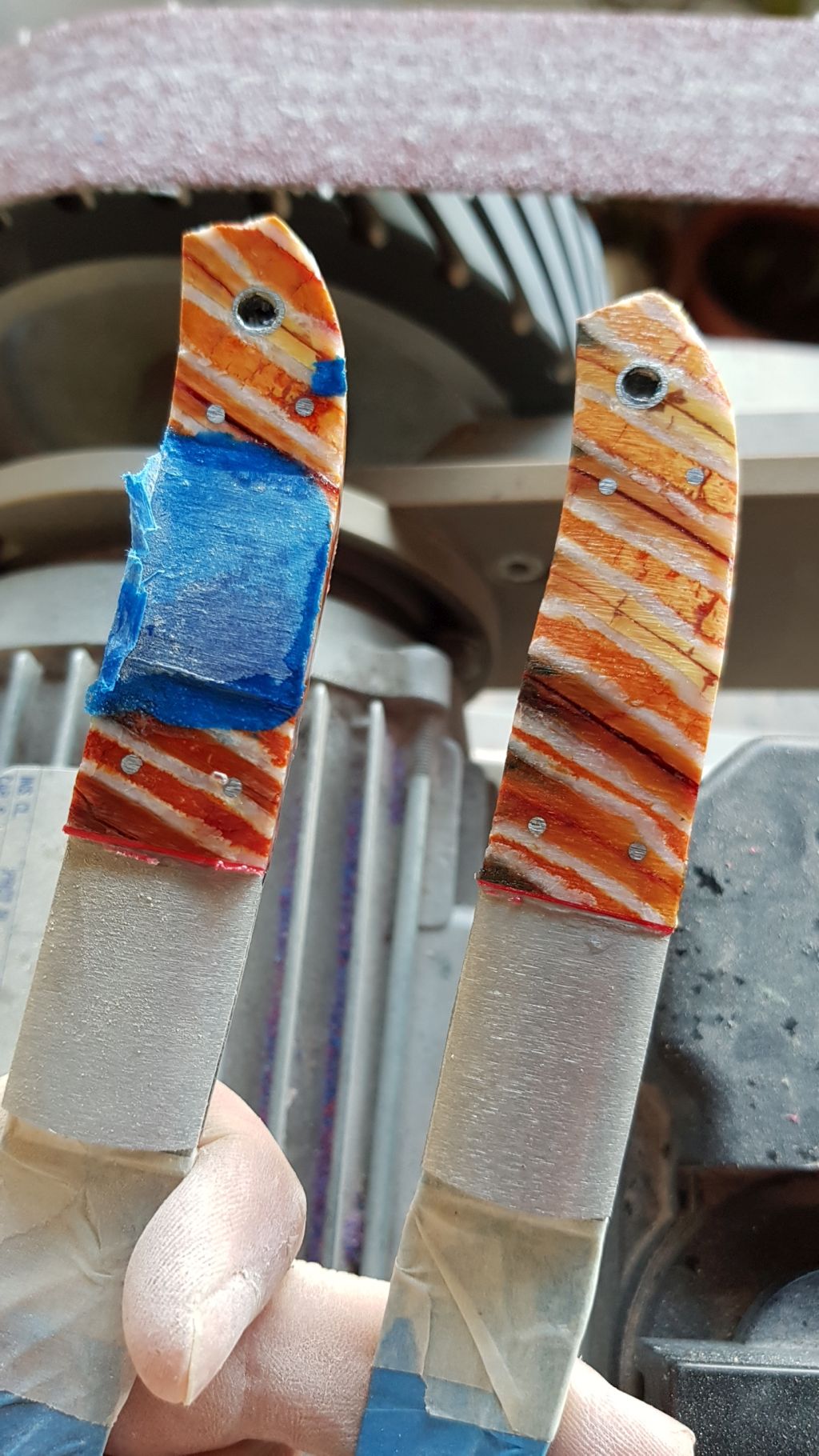

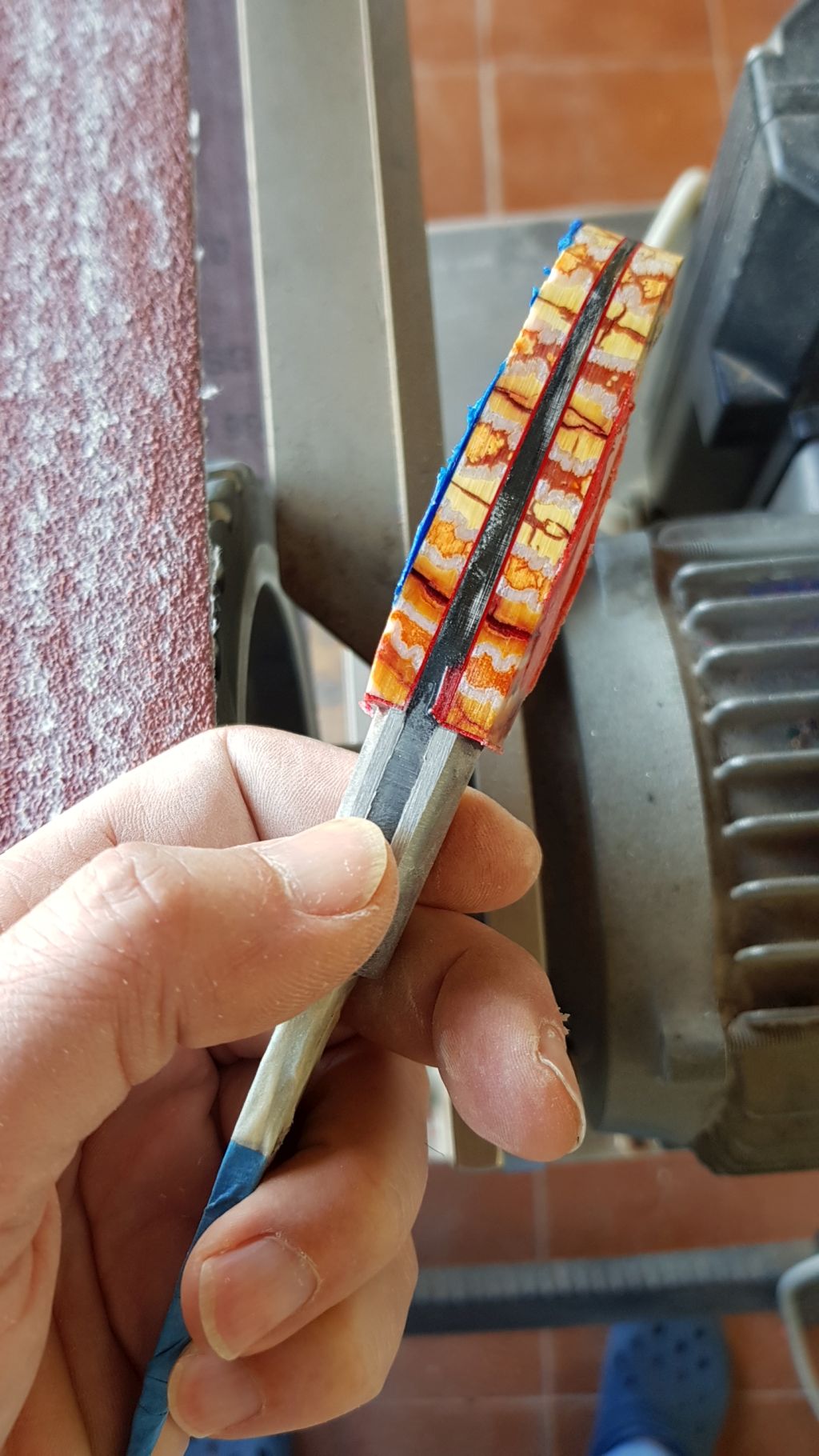

Just finished my first attempt at damascus and started grinding only to find delamination :-/
Suggestions welcome! It's 1084 and 15N20 in a propane rich forge using regular borax. I ground each piece of steel before welding and pulled it straight out of the forge to my anvil as quickly as possible, using light-ish strikes from the middle towards the edge with a hammer with a fairly round face.

After you set the welds, how much more forging down did you do? It almost looks to me as though you got the welds set for the most part, but didn't get completed coverage with hammering after the fact, or, maybe didn't have quite even heat soaked all the way through the billet.

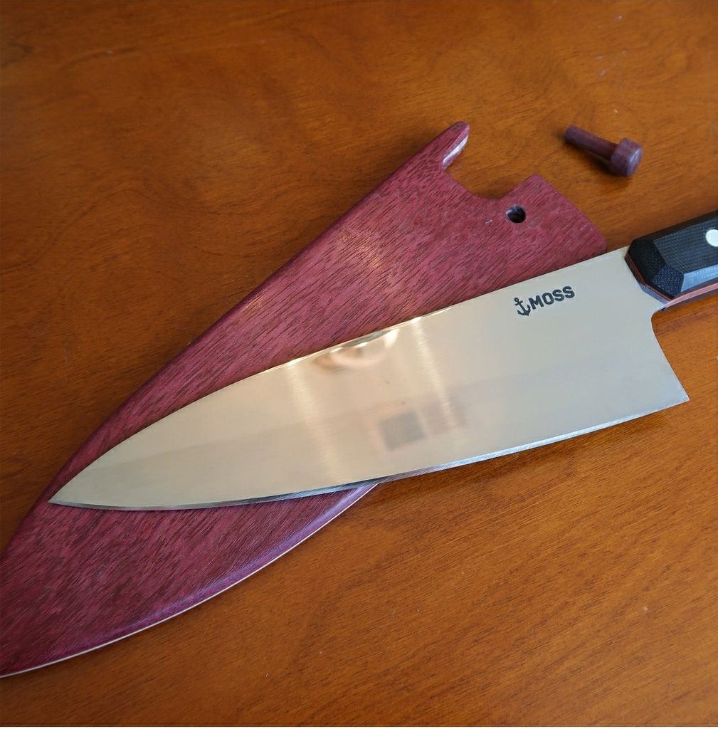

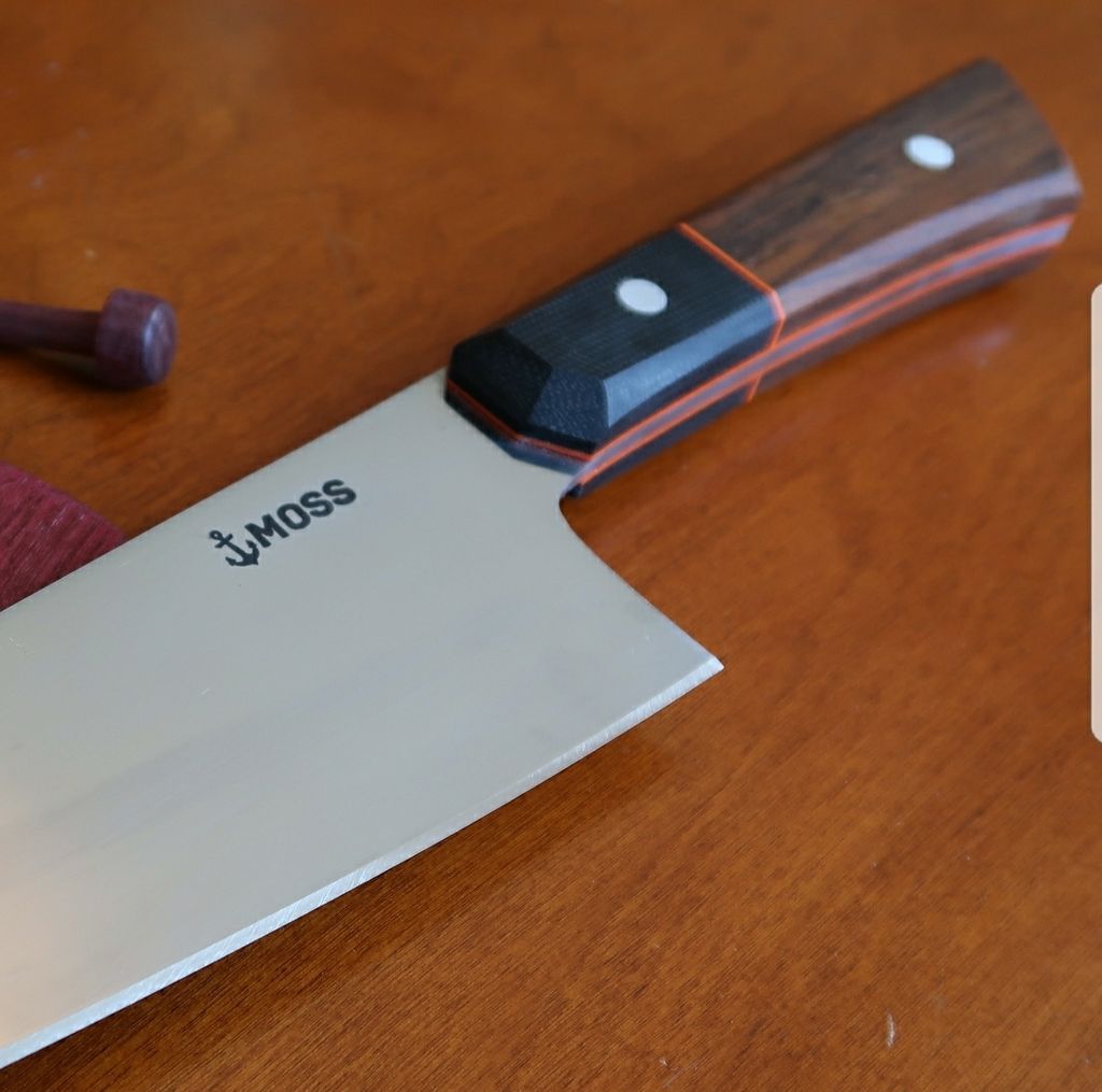

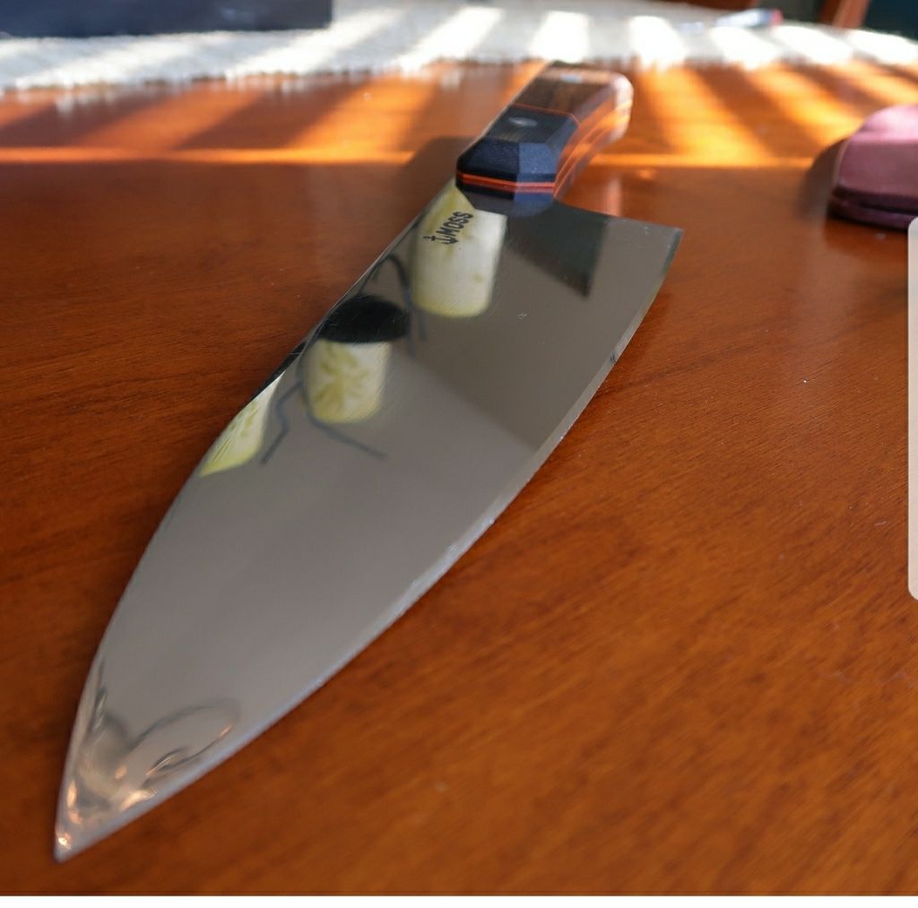

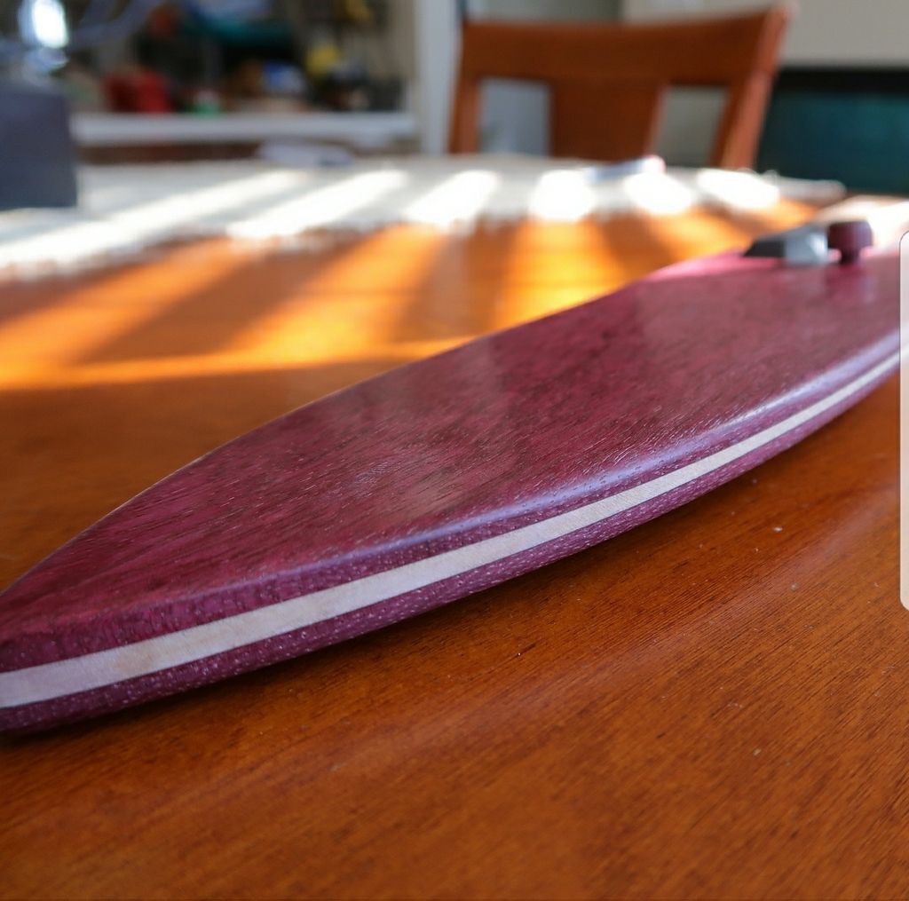

I don't post much, only a handful of knives so far, but this is probably the first knife i have been mostly happy with. My first kitchen knife and first saya. 1084 cocobolo and G10 scales. Saya and pin is purpleheart with a basswood liner polished with a mix of mineral oil and bee's wax. This one just seemed to fall into place, such an amazing feeling.
Hmm, yes that could very easily be the case. The initial welding I tried to flux it and get it up to temp about 3 times, but I never really went to town on it like I could have to make sure I covered every little part of it. Maybe that's what I did wrong. I may not have waited long enough and only the outside got the proper temp too. Thanks for the advice!
Thinking about it some more I really do think that it was less about the heat and more about where you put pressure. When I first built my forging press, I naively assumed all my troubles were gone and found very quickly that if I didn't get pressure on every square inch of the billet during my welding heats, I would end up with some delaminations like yours. But instead of being very localized and surrounded by good weld, they tended to be across the billet in the direction of my press dies.
Changing to flat dies for welding that put less pressure per square inch than the rounding dies I started with, but covered more area more evenly, made that go away completely.
