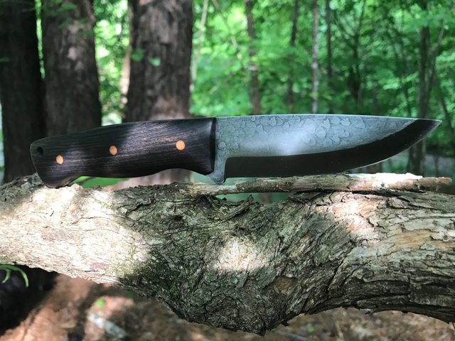

Finished up this fighting knife in O1.
I'm trying a new material for me called Ebonite on scales. It is an old hard rubber material that was once more common. You don't see it much anymore but I like the way it feels in the hand. This was scavenged from a 60 year old rubber bowling ball but I have some new material on order from a manufacturer in Japan. If it holds up well this may end up being a cool material for scales.
