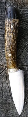

Slipjoint #5
I think that I am going to need one of those...
I like it ! @Stromberg Knives , you have hidden pins and that stainless pins goes through both scale or are just inserted in scale ? I like them...:thumbsup:
Thank you, I appreciate it. They're actually not hidden pins, all the pins are through both scales and blade. But the ones at the ends are carbon fiber and camouflages their selves pretty well.
