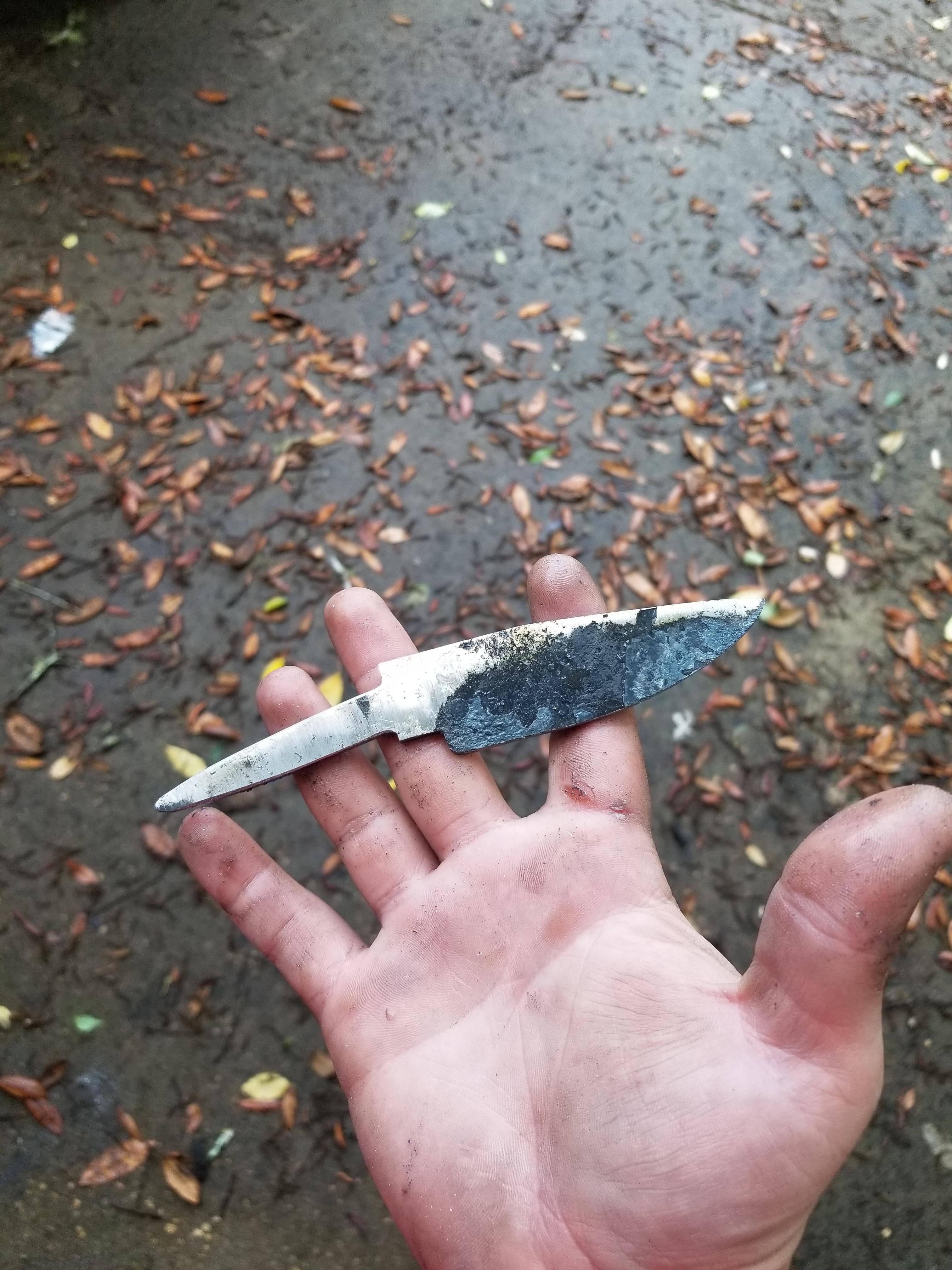

I've decided to strictly focus on forging from here on out. Did stock removal for a while and got into folders but forging is where my heart really lies. Heres a little hunter I just forged out the other day from cru forge v. Got it forged out, profiled, and grinded to pre heat treat dimensions.
@valknut my friend , you need to put handle on that tang ....I can t imagine one on that tang as it is now .I think that you need to make some correction on tang .....:thumbsup:
Yeah tang was quite small on that guy. I ended up scrapping it anyway. My file guide slipped off my ricasso and screwed up the plunge line. \_:confused:_/
