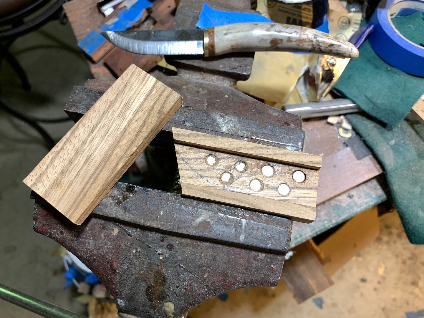

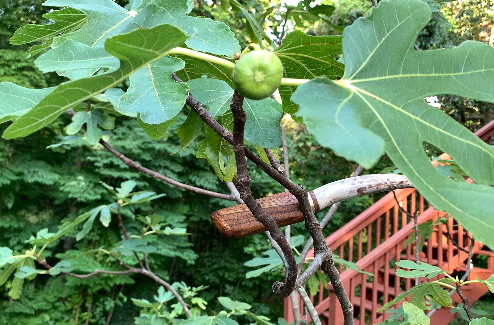

Finishing this one up. I’m really enjoying this forum, great workmanship of all types. Until I found this forum, I thought I was the only guy with this knife disease.
This is a 60mm Scandi grind and the magnets are dry, the cover and spacers are ground to fit

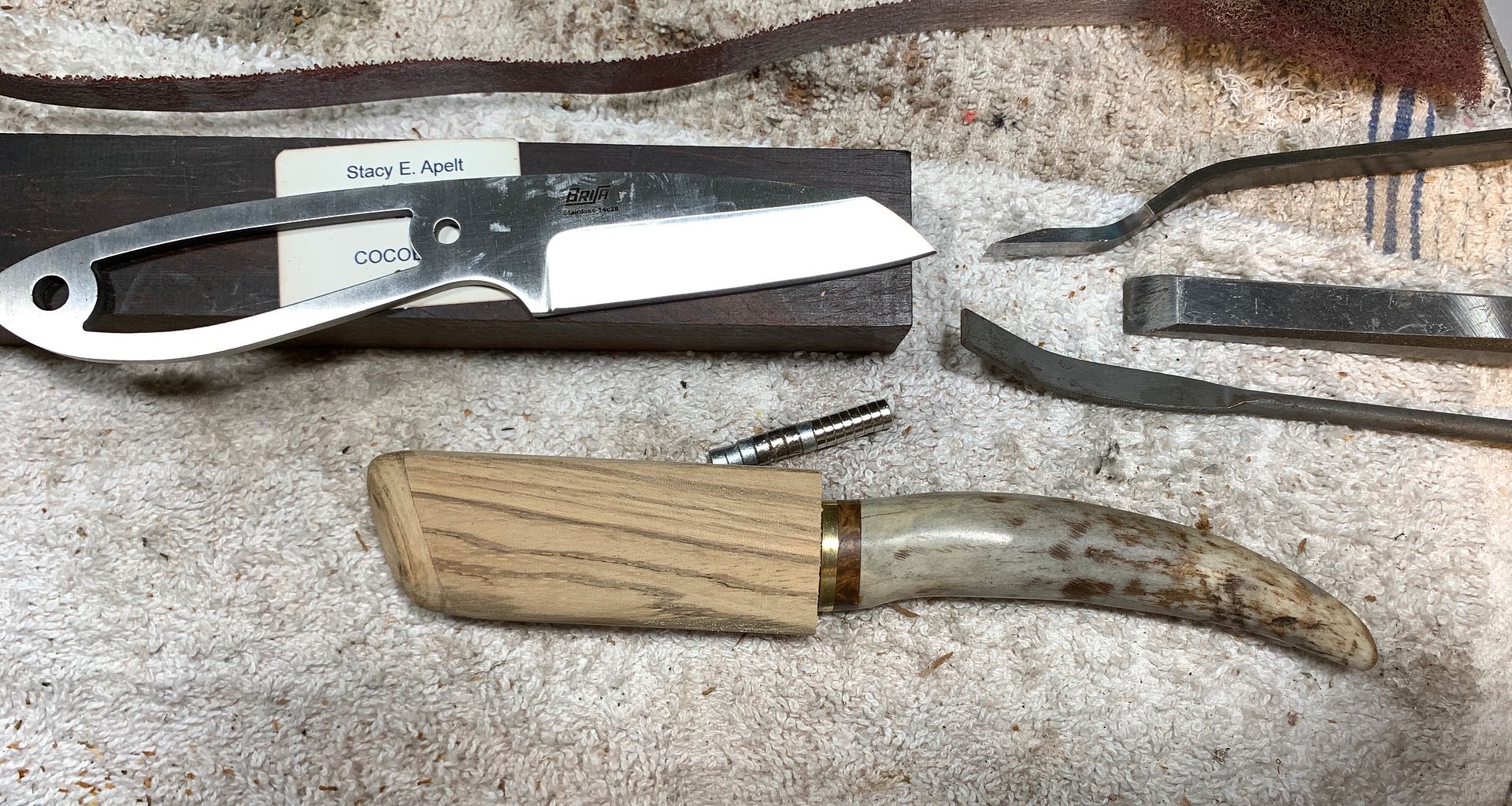

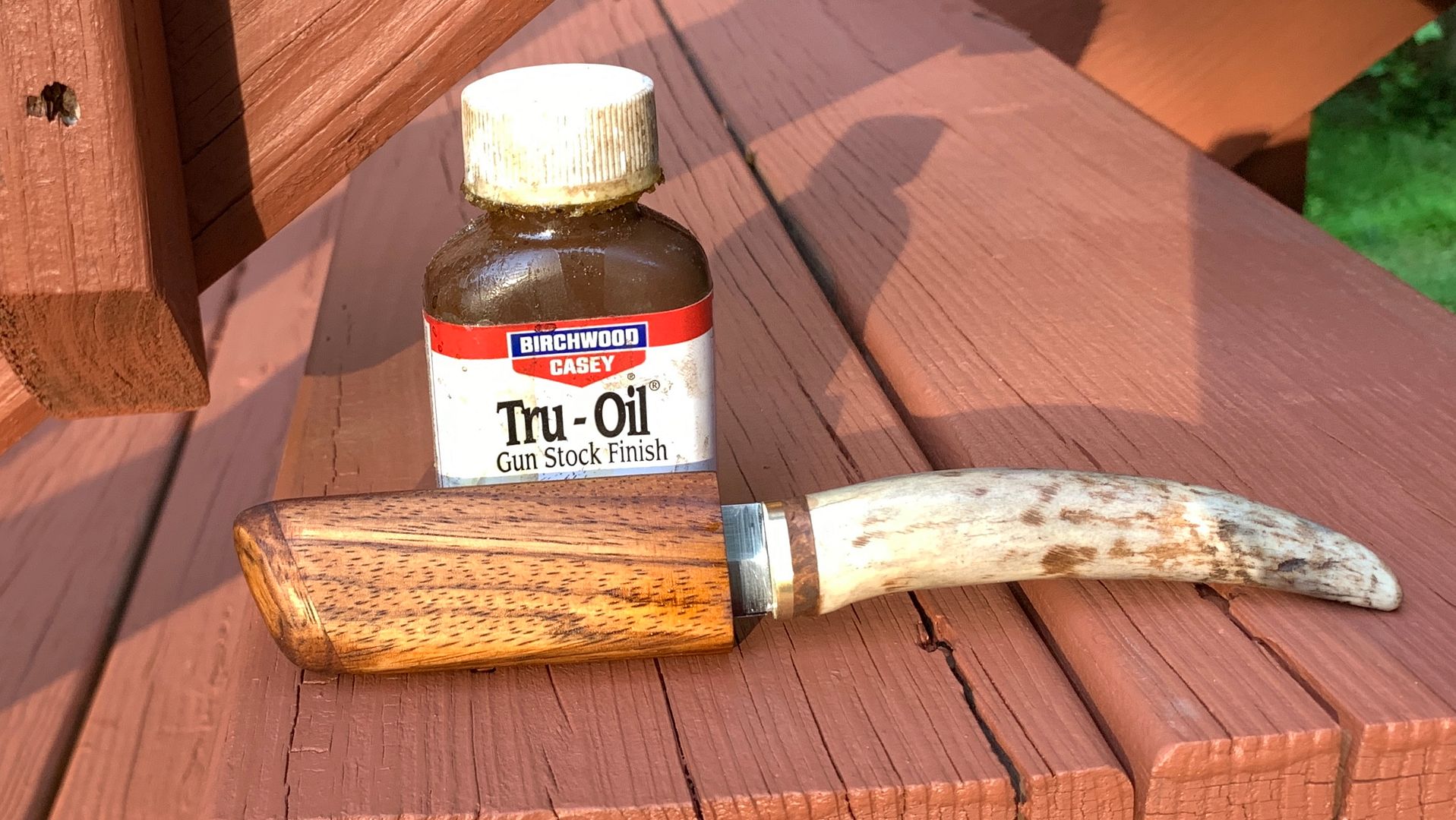

A little Tru-Oil and this one’s done. A little less embellishment than the others. This one is Moose Antler and Tiger Wood
Cocobolo Wharnecliff is next. Great wood! I see a roadtrip to tidewater va coming soon

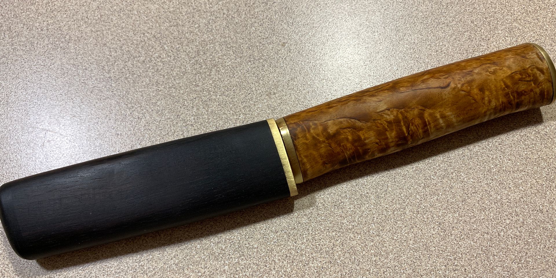

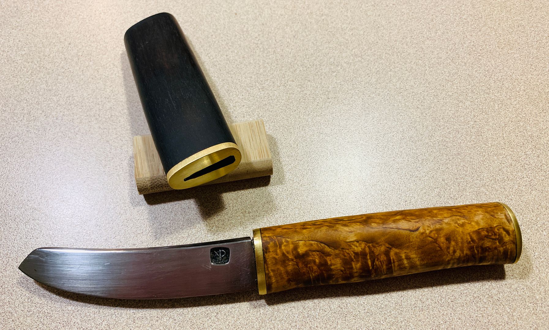

This is Karelian Curly Birch and woodwind quality ebony. Years ago I bought a bunch of ebony in the estate sale of a clarinet and oboe maker in NYC. The birch comes from Russia. One of the prettiest blocks I’ve worked with.
The blade is a hand forged Puronvarsi 95mm Bullnose flatgrind. Krupp carbon steel. Probably a Volvo leaf spring?

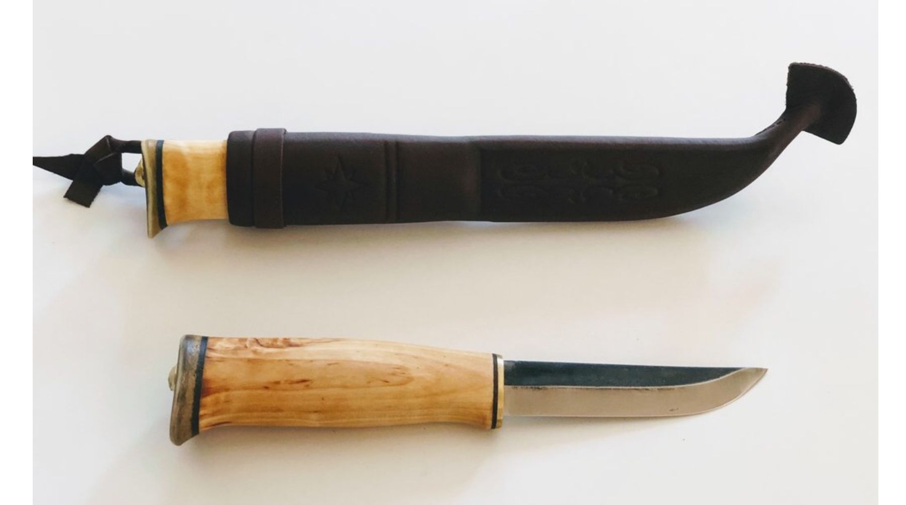

Its a variation. Traditional Puukko’s have a leather wrapping around the wood. The traditional wood is spruce or soft pine. Not important if the leather will wrap it
Like this

Good question. I seal all my scabbards with TruOil in order to block any humidity being absorbed by the wood.
Pine does not have tannins, it has resins. Oak is the tannin bearing wood that is often mentioned about not to use where it will contact steel. Mostly it just makes [the wood blacken and tarnishes the steel.
For the trivia folks, the word tannin comes from the latin word for oak bark. Oak bark was what was used to tan hides for millenia.
Torqueguy -
You need to thin those sheaths down much more. Properly made, the sides are no more than .10" thick. I often go to around .06" thick. The sheath should be only a tad larger than the blade. Nothing wrong with all wood puukko sheaths as compared to leather coated ones, but the leather is more tradition.
