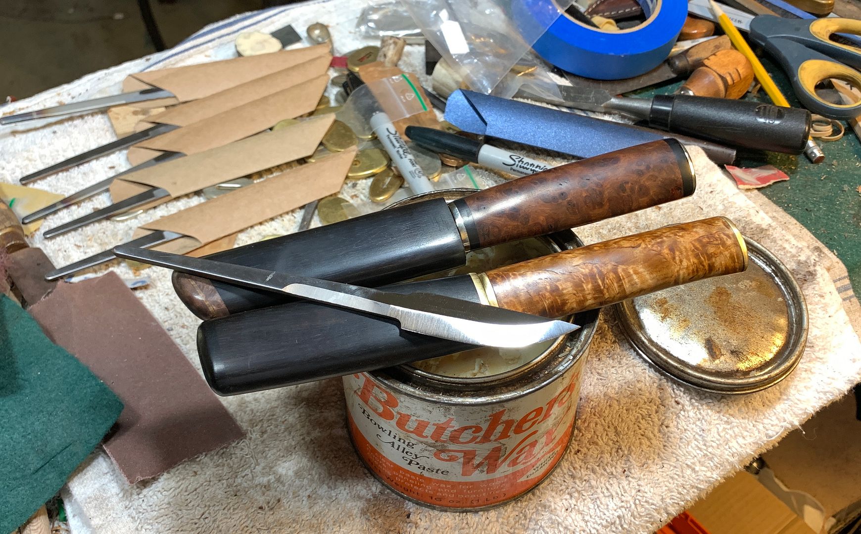

The reason for the thickness is twofold. I countersink round magnets into the inside of the scabbard. If I thin the sides of the scabbard too much I run the risk of exposing the magnets from the outside. The second reason is I design these puukko’s to ride in my front pants pocket. If the scabbards are two thin, the knife tends to rotate in the pocket. The question that arises however is how practical are the magnets?? They really click and snick the blade in the scabbard and hold the puukko snugly.
Pine does not have tannins, it has resins. Oak is the tannin bearing wood that is often mentioned about not to use where it will contact steel. Mostly it just makes [the wood blacken and tarnishes the steel.
For the trivia folks, the word tannin comes from the latin word for oak bark. Oak bark was what was used to tan hides for millenia.
Torqueguy -
You need to thin those sheaths down much more. Properly made, the sides are no more than .10" thick. I often go to around .06" thick. The sheath should be only a tad larger than the blade. Nothing wrong with all wood puukko sheaths as compared to leather coated ones, but the leather is more tradition.

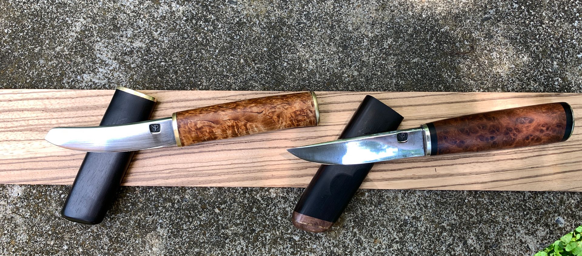

The law hasn't passed yet so you can still carry fixed blades up to 12cm. But I like to be prepared.
Shop is going through another "facelift", but was able to squeeze this one out on the HF 1x30 wonder grinder
15N20, OAL 7-3/4", blade 3-5/8", African Blackwood bolsters, g10 pins, spalted tamarin with red liners. RC 62-63.

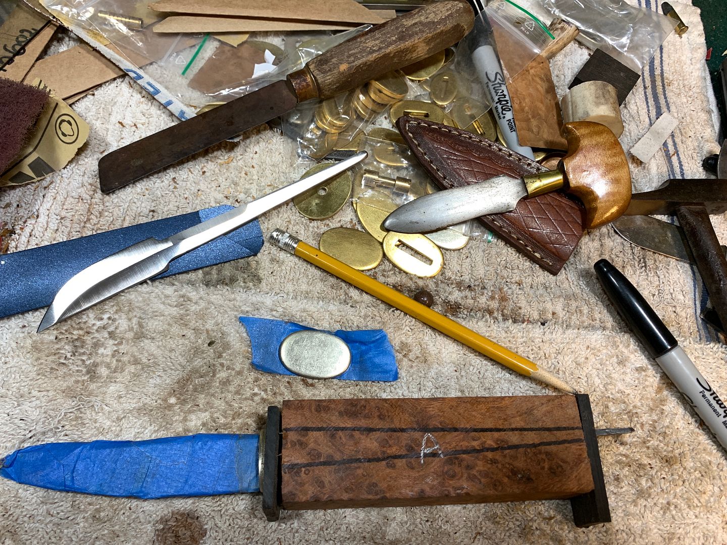

Making mill reliefs and soldering bolsters on the liners
Grinding the front and bottom of bolsters, leave the top alone for now.
Grind the clip and rough grind main bevel after putting in the nail knick
Put it all together for a test fit
