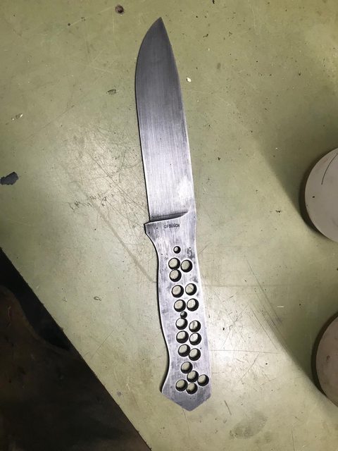

Sweet! How do you get your name on the spine of the blade? I am a newbee so I do not know alot of the detailing!!!!
This is called electro etching. You need three main things: 1) a stencil; 2) and etching machine that usually gives you the option of applying DC or AC current; and 3) chemical etchant.
There is a lot of discussion on etching here in the forums and online and many different ways to achieve results. This can range from a 9v battery to $1000 machines.
Do you give any idea of my sources.
1) stencils: IMG Electromark in Utica. I send designs and we had a back and forth until approved, and I ordered several sizes
2) etching machine: Custom made by Maxim Peysakhov on facebook,
3) etchant from IMG Electromark

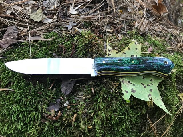

Thanks Bro. But I going to start trying some new steels. I never had the patience to send stuff to a heat treater but I finally got a oven, dewar, and Rockwell tester. Now I have to figure out which steel to try. I just tried out some Nitro-V that I have been sitting for like a year with no way to heat treat. Its a good steel but I wouldn't say great.
I think I'm gonna try some s35vn next.
I really like that hunter, and the bowie you posted on IG.
Haven't tried my piece of Nitro-V yet, but if it performs like AEB-L, I'll love it. Not sure if the marginal difference will be worth the trouble/expense, but the name sure is cool. :p S35VN I find less interesting due to the substantially lower toughness at the same hardness. But the right material for the right knife...
Haven't tried my piece of Nitro-V yet, but if it performs like AEB-L, I'll love it. Not sure if the marginally difference will be worth the trouble/expense, but the name sure is cool. :p S35VN I find less interesting due to the substantially lower toughness at the same hardness. But the right material for the right knife...
Thanks:D :D The Nitro V isn't worth twice the price as Aeb-l. You right about the catcher name though. I wanted to try and make some fine slicing hunting knives with it. So I'm less concerned about toughness and more concerned with wear resistance and strength.
If by "strength" you mean resistance to snapping the blade, it will probably be hard to beat AEB-L in that category in stainless.
Larrin's testing suggests CPM154 would beat S35VN in that regard too, while offering a great deal more wear resistance than AEB-L, without considering the various Z-* steels.
