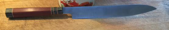

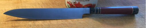

this is the last of the thin O1 stock I bought some 19 years ago now. Had one long, thin piece, so decided to make something japanese/sushi like to continue developing my Wa handle approaches. Not quite the correct shape towards the tip - but best to call this a Sujihiki. O1, flat ground both sides, tbe ~0.005", handle (Wa - "D) is grey Dymondwood (bolster and butt) with copper separators and purpleheart (I think) main handle. Being the mathy nerd I am - the relative dimensions of the pieces making up the bolster and end cap are calculated from the "Golden Ratio". I kind of like the look.... (despite appearances - the balance point is almost exactly at the ricasso. blind luck) time to make some Sushi for dinner!
