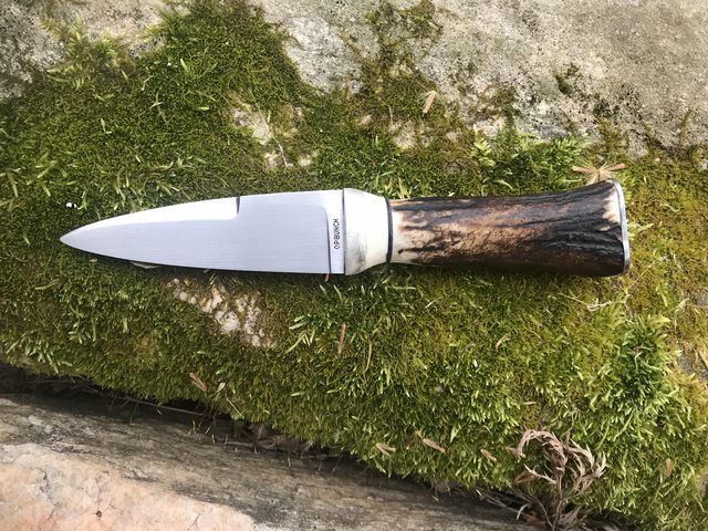

Here's my latest tribute to old Horace Kephart, a custom job in 1/8" 80CRV2 and Ironwood, with convex grinds above and below. In the photo the handle's sitting at 400 grit, it's now at 1200 and I started oiling tonight, final touchups and off to it's new home. It was near sharp already and I just touched it with diamond and stone and wow it's sharp, I suppose I could call it a convex edge. The blade is 4.9" and handle is 5".wip2.JPG

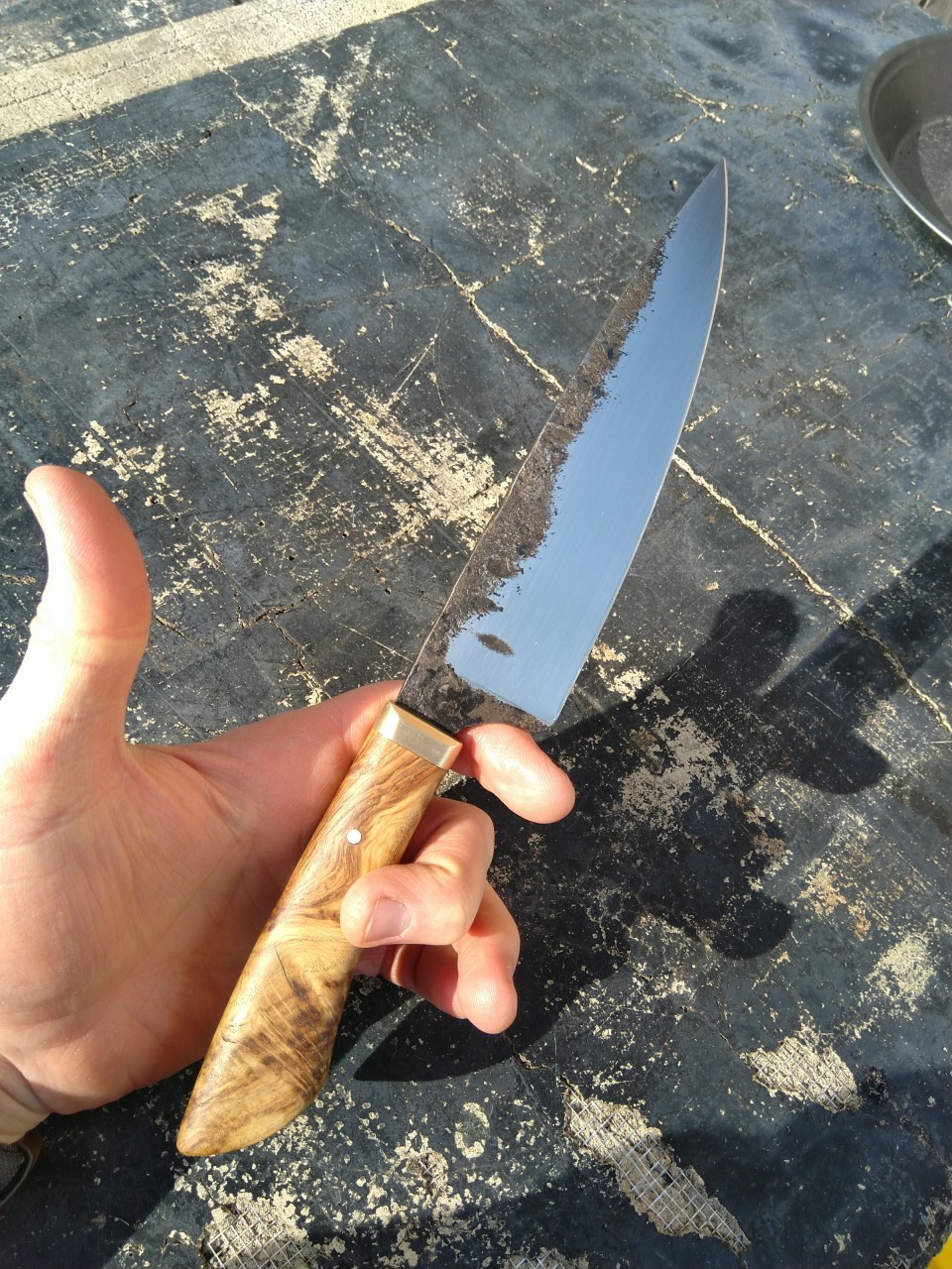

@HSC /// They all look great, but on the bottom one I have to say you Really nailed the profile. It looks excellent!
Thanks very much
I’m sort of a spontaneous maker and while I use some guidelines I rarely use a pattern. Most knives are a little bit different and usually one of a kind
That specific one just went to a chef back east
