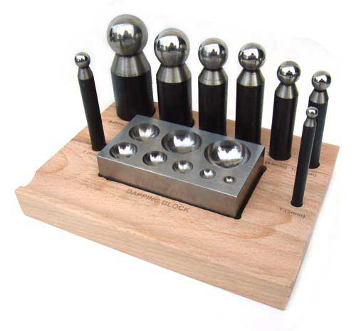

Love this domed pinn, but talk about patience! Tapping a few hundered times wearing ear protection, but it is something I want to get better at.
The knife and my extra special modded doming hammer :)
Hengelo- are you using a setting anvil for the pin? They make "dished" anvils that might make that much easier, although I haven't tried mine yet. I want to say that I picked it up at Tandy Leather, but it's been a few years. Knife and sheath look great too.
Thnx.
It's my first time doming and had to find a way that works. Didn's know about those special anvils, but that sounds good.
I clamped the pin between two pieces of wood with a hole drilled in them and domed one side first.
Then put it trough the knife, balanced the domed side on an other ballpeen hammer and did the other side.
It's these small detaills that I enjoy most!
I thought your hammer was photoshopped when I first saw it, LOL. Doming pins is a heck of a lot easier if you can put the knife in a fixed position to free up both hands so you can hold a hammer in one and a punch in the other. :)

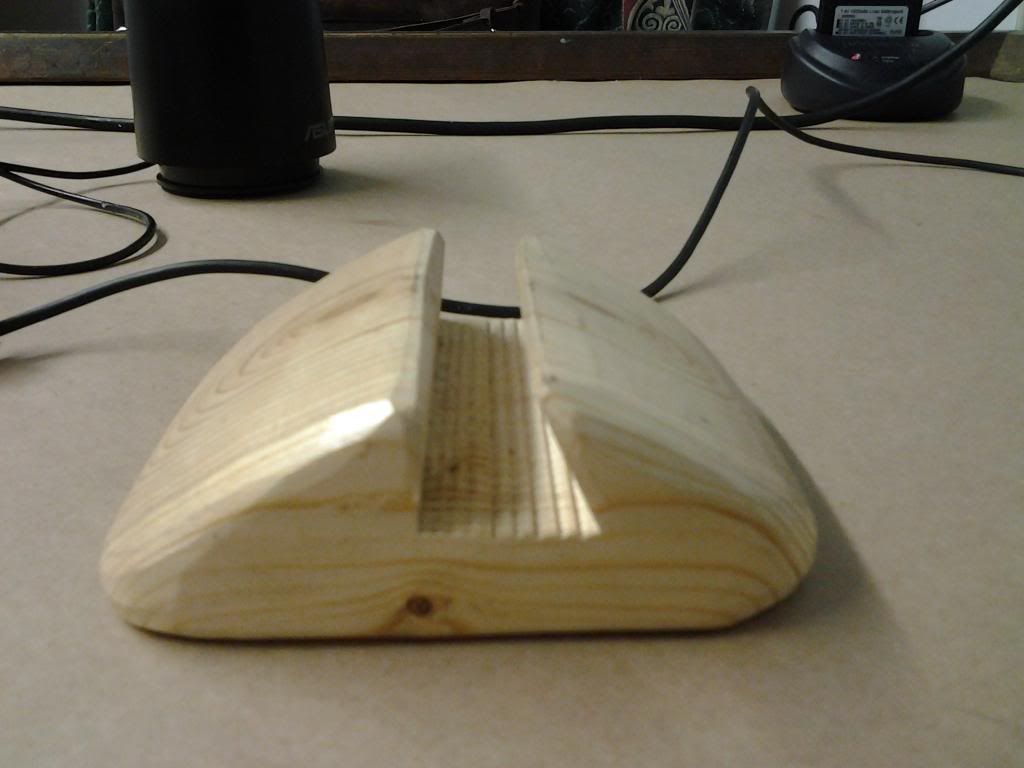

Not knife related but I came up with an easy multi angle tablet stand made from a chunk of 2x4 and multiple passes on a table or miter saw.
tablet not shown as I was taking the picture with it.
The hammer does look strange :D I cut the other end off to save weight.
What kind of punch do you use?
I've been looking at goldsmith doming punches, is that what you mean?
