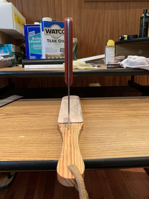

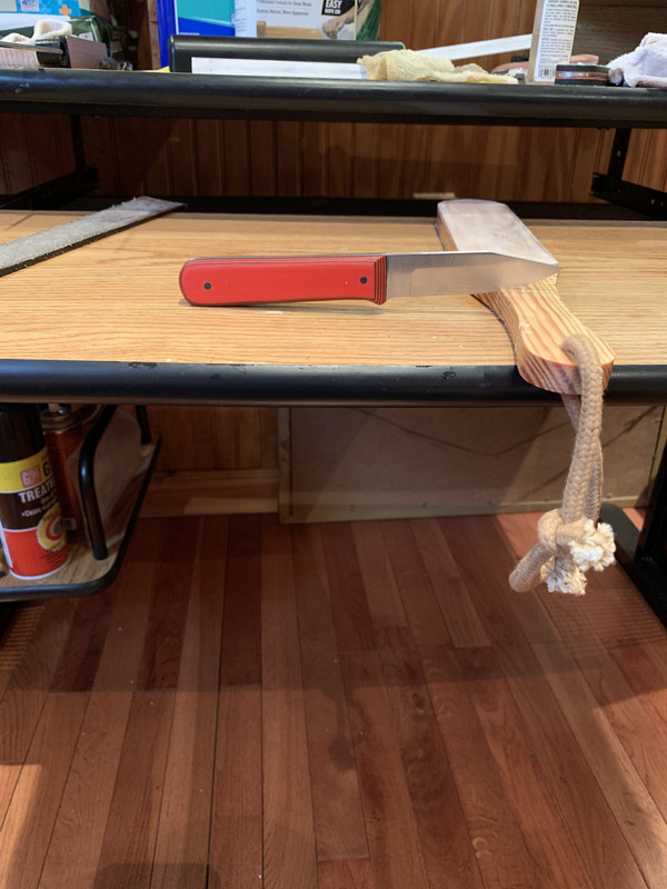

Here’s a paring knife I’m finishing up. It has black and red G10 scales, black liners, black pins, and a 26c3 carbon steel blade.
