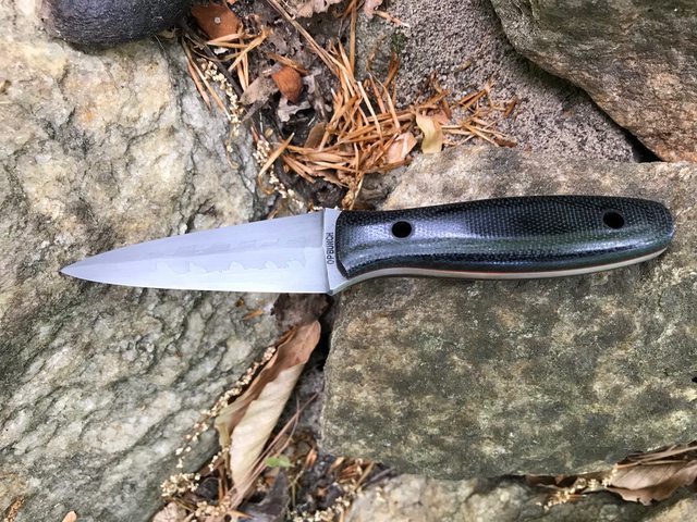

Finished up my first attempt at a hidden tang knife. This one is a 4” hunting/skinning knife. It’s forged out of 80crv2 with an elk antler handle and a brass bolster and butt cap with black micarta spacers.
Outstanding John!made this for as friend who helped me out. mammoth tusk scales.
