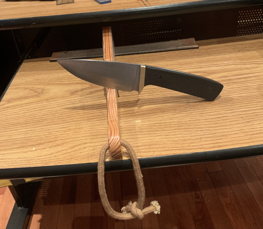

This one is finished, just needs an edge and sheath.
150 mm blade, 4.7 mm A8 Mod steel at 61 Hrc. Convex geometry, distal taper. Micarta, G10 liners, corby rivets.
