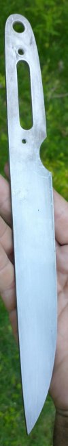

I am really liking wheel grinding, and the grinds that come of this 500 mm wheel. Slicy as hell. Finish is 120 grit compact grain --> maroon Scotchbrite.
