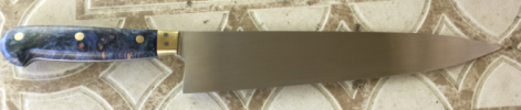

I finally got to finish this one (in the works since last autumn). A western style chef's knife .... actually patterned after my old, old, Sabatier chefs knife. Blade profile modified a little though to more resemble a japanese profile (ok, I guess some might call this a Gyuto :).. S35VN at 62 HRC. blue dyed spalted maple (courtesey of WEO. I did take the time to hand sand this blade .... not perfect, but you can definitely tell the difference.....
I curious as to the thickness of the edge prior to heat treat. How thick are you leaving it?
