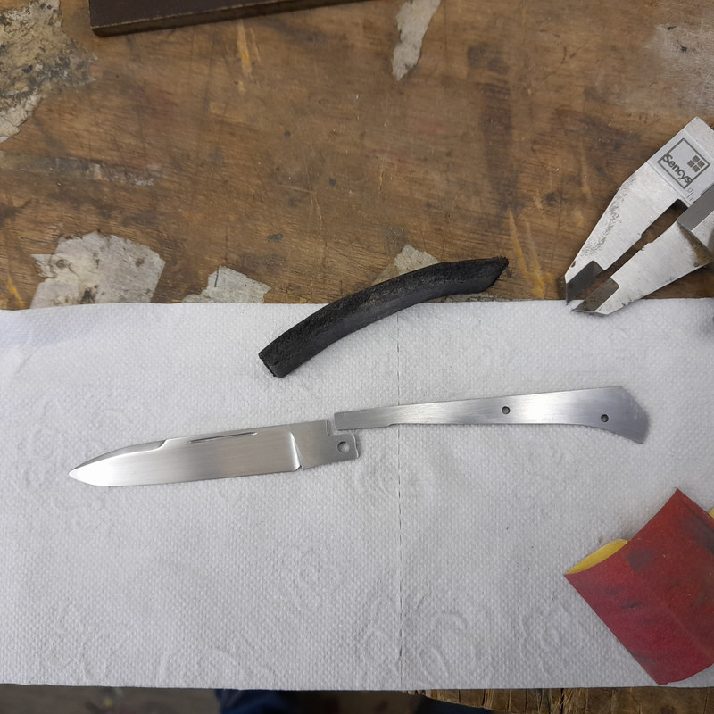

got this lil guy more or less finished today

This is slipjoint #9 ready for HT.
(this makes 3 to send off)

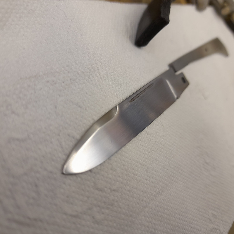

These swedges look cool but also realy remove material and give a thin and sharp point.
I used a cheap ebay knife as a template but that doesn't work for me. I just ordered 2mm paper micarta to make templates out off and be able to scratch good lines.
