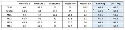

Tested my furnace on some coupons
As quenched. No tempering
Freezer treatment
I used the MagnaCut spec sheet as a base. So four different temperatures at four different times
Liquid nitrogen doesn’t seem to be available outside of industrial sales. Working on locating dry ice now
