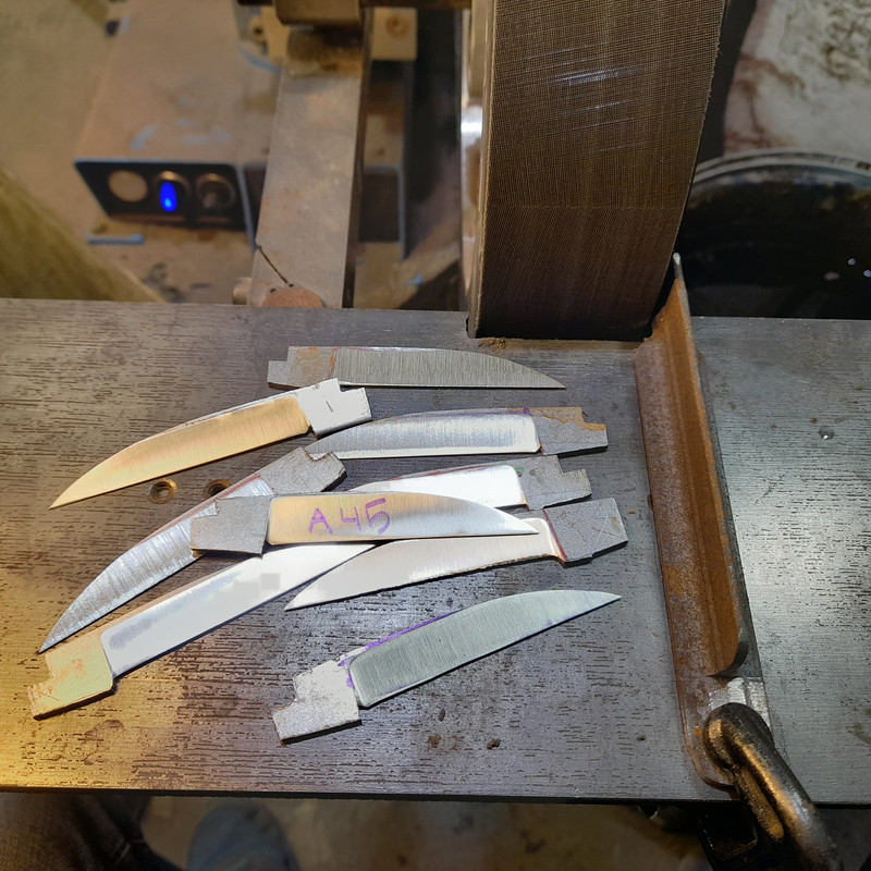

I want to get better at grinding bevels so I got a sheath of slipjoint thickness mild steel to practice.
And I think I'm getting somewhere!

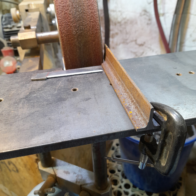

I also improvised a rest like Meades uses in his grinding vids on youtube and I realy like it.

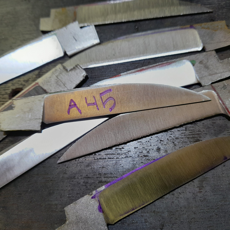

The blade in the middle of the last pic I ground to A45 (~320). If I can duplicate that in a knife steel I'd be content with myself!
I knock off the 45degrees with an old 60 then go 80, 120, 240, A45
