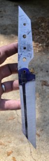

Been tinkering with the idea of trying to make one out of all parallel lines for a while. Started grinding one out today to get a feel for it. The swedge goes too far back and I think I’d like it to be at an angle instead of straight with the spine. It’s not a design I’d ever seek out in a store but it’s been growing on me since I started drawing it up.F90B3336-DFE6-4C9D-995F-24826C03AF8E.jpeg
