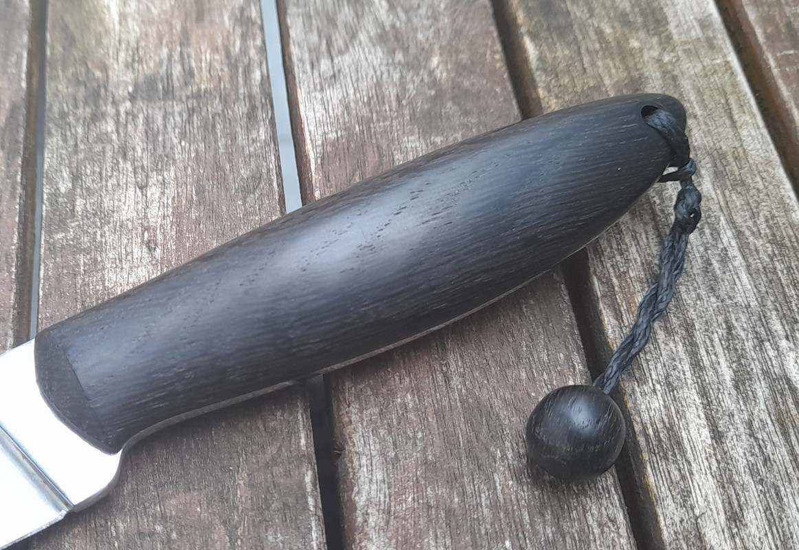

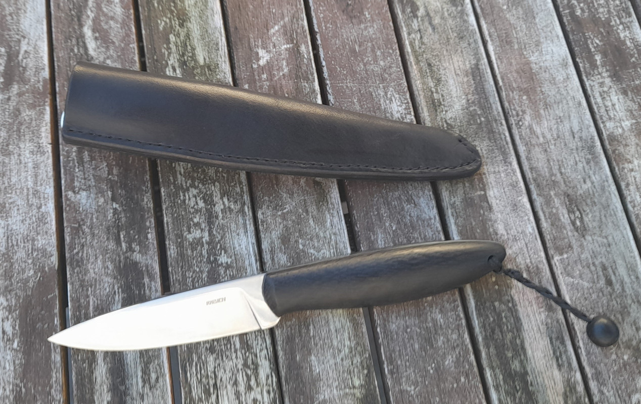

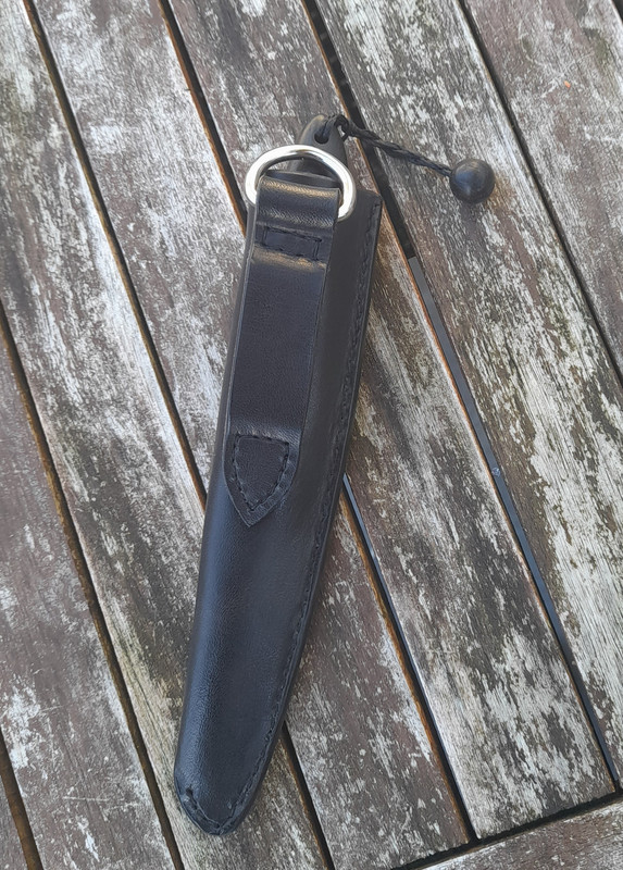

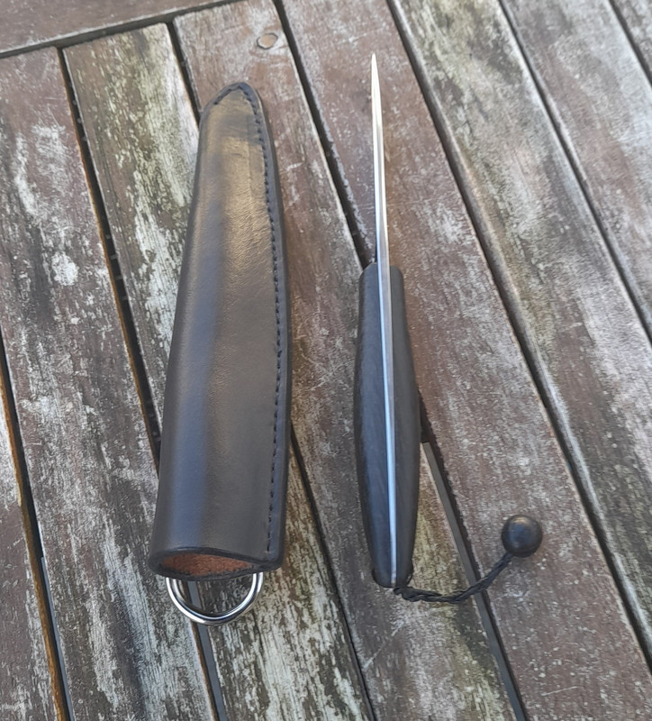

My model Ibis with Irish bog oak.
The sheath is a special design to the taste of the new owner. He is happy with it and it's been an enjoyable process for him and me.
Bog oak is beautiful and a pleasure to work with. This piece is 6000-8000 yo, so a Mammoth might have scratched his back on it while the tree was alive!
Nice looking knives.

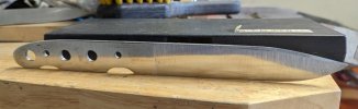

Experimental design for slicing performance. It's 0.1" thick Magnacut, FFG, to be hardened to 63 HRC. There is no choil and the plunge is extra crisp and actually angled slightly back towards the handle. The handle has no protrusion below the cutting edge. Swedge is 70 degrees included (35 each side). It's going out for heat treat tomorrow, possibly with added jimping.Molokai.jpg
