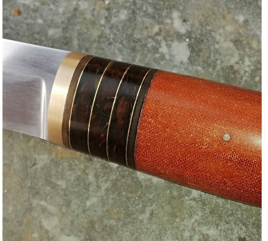

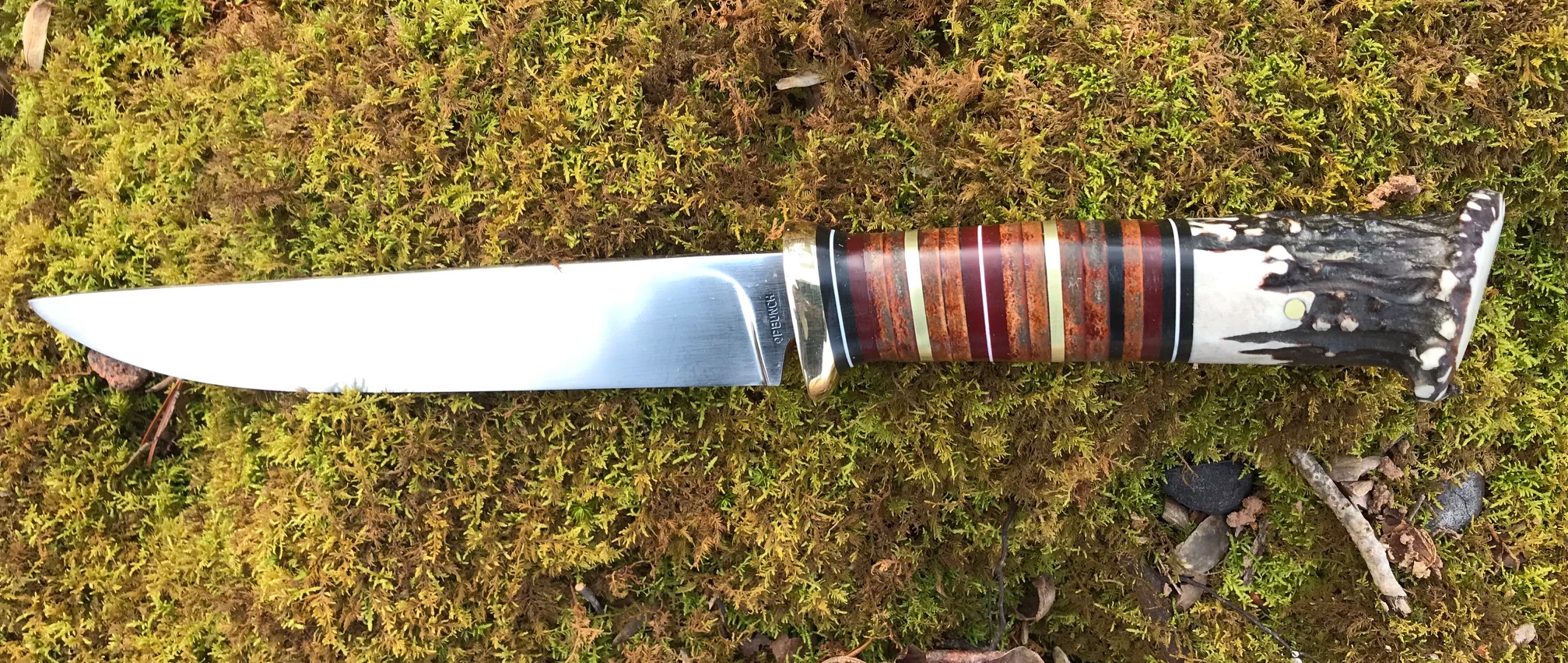

Finished an other Sami style puukko.
I realy like this micarta, it is not stacked but 3 layers rolled into eachother. Plus I had some smaller pieces of rag micarta that make for some interesting spacers. It has a rombic tip but full thickness and rounded spine. Bronce guard, stainless blade.

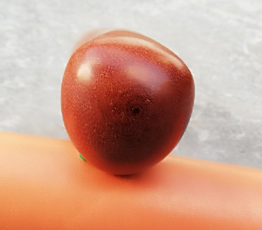

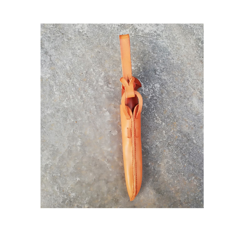

Elmax again, cocobolo handle, stainless hardware. This time it's a rat tail construction with a blind stainless nut at the butt. The colors are all over the place in these pictures, I can't seem to get it consistent - sorry about that. It actually looks more dull in real life.
