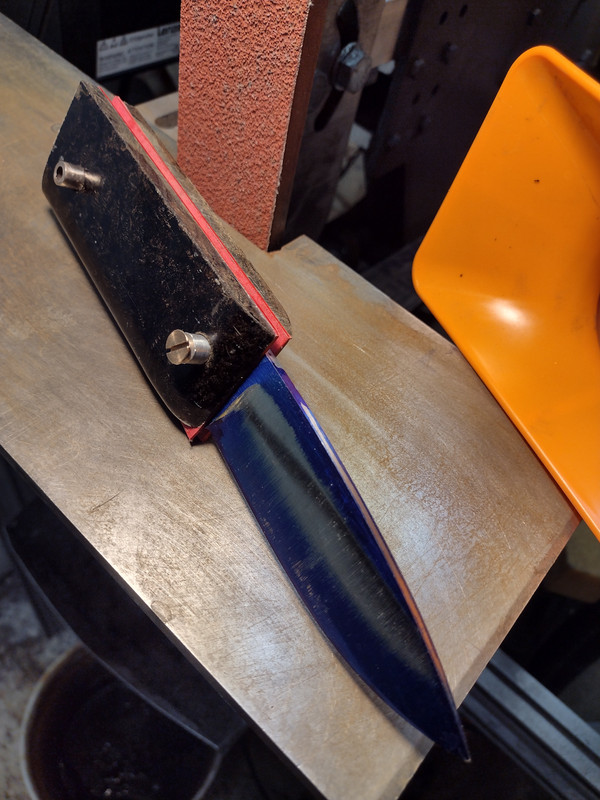

I picked up some vintage rag micarta from WW2 for a Birthday present for my FIL this upcoming May.
It was from the Navy, and he is a Proud Servicemember, and I know he should like this as he is also a history buff..... and likes knives, and I haven't made him any yet
Yikes that stuff STINKS.
I wear a mask, but Im still kinda worried just how bad my shop/basement/house is going to stink!
All I did so far was flatten it, and glued it to some liners.
It was sized kinda crappy with odd thicknesses, I can barely fit my not large handle in the usable area. & It cost A lot for what I am used to :/
I hope I can make this work.
I Wouldn't be making anymore knives, If they were all like this..... :/
