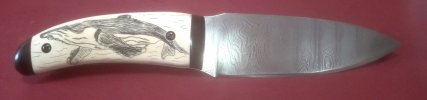

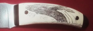

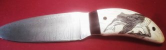

I finished both knives yesterday. I have a little touch up to do on the scrimshaw on the smaller one, but that won't take long. The two knives have around 100,000 lines total. I like to do the traditional scrim style artwork where the number of lines and crosshatch determine tone density.
I am going to experiment with some old line gravers that make many lines at one time in hand engraving. I will see if I can make a 4-line graver into a 4-line scrim tool. That might allow light background fill or other effects.
Some of the photos seem a bit overexposed due to the white/black contrast and editing I have to do for them to show up well. Click any image to start the slide show. Once in slide show, click any image and it will expand to greatly enlarged for close inspection.
That is a true work of art! Nice job!
Thanks, I have a bit of fixing to do on the swimming whale. I have to change the fin. There is too much ink in the lower part. Also, I haven't added the bumps along the upper part of the snout. I'll post the before and after later on that one. I also spotted that I have some excess ink to rub off at the baby whale's snout. Mom needs a few more accent lines in her tail, too.

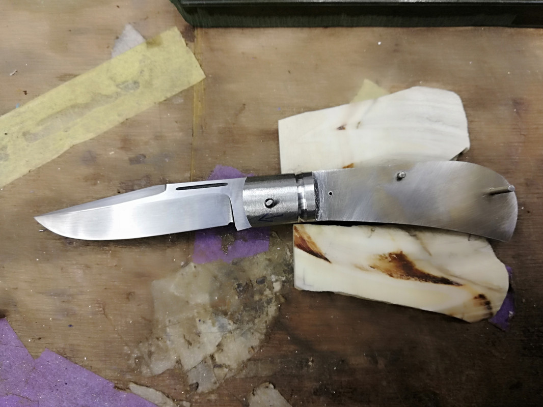

Couple of weeks ago I saw a knife in this thread from Navman that had a rounded spine and some jimping and I really liked it. This is my first finished blade with those features and even though I could have rounded the spine a lot more, I still like it and will do more of it. So thanks to Navman but also many others for all for all the inspiration I get from this thread.
I am a little bothered by the rough finish inside the decorative grooves on the bolster but maybe we can say it's "rustic".
