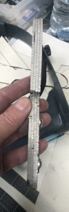

Today’s “Why didn’t I think of this sooner?!?!” moment is brought to you by two 1/4”-20 screws. I’ve been trying to get more consistent. Don’t know why it took me so long to think of this. I went from 4 rough cut blanks to 4 essentially identical blanks with pinholes drilled in about 35-40 minutes.
I do the same with superglue.
I’ll be trying that on the next batch. I always put two 1/4” holes in my blanks to mount to a couple of fixtures I use so I just threaded the holes in one the blanks. I’ll drill it out to 1/4” when I’m ready to move to the next step.
