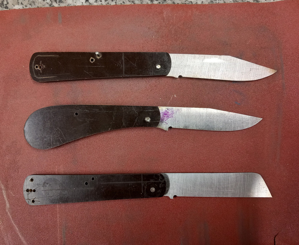

Started a new batch, experimenting with kick shapes
