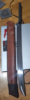

I don't post much but here's one I started years ago and finished recently
