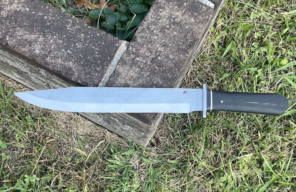

Got the Magnacut Kephart finished and shipped to Hawaii:

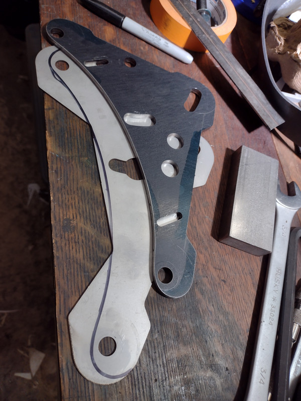

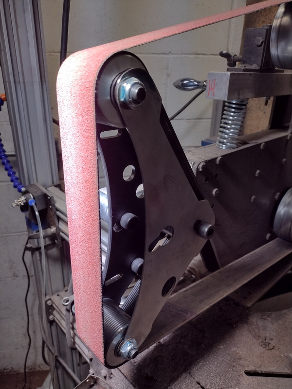

I keep bumping into structure and guarding on my platen, even though there should be room/clearance...... Today, I ground away More. Clearance.
I Should of just made the thing from the start, it would of been easy enough....Next time.
