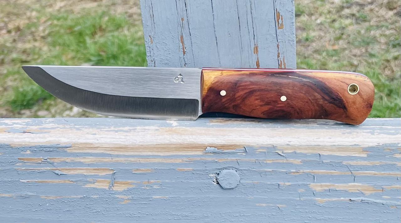

Here’s a drop point hunter I’m finishing up. The blade is SF100 stainless steel with burl wood scales. So far I’ve sanded the scales up to 500 grit. I’m not sure what species of wood the scales are, any help would be greatly appreciated.
Beautiful wood.
Try lining out the pins from the top of the handle. That way you get a flowing line
