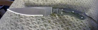

Okay here's what I didn't tell you before. For R&D, I ground this MagnaCut WAY TOO THIN and wanted to see what it could handle. I did this upon arriving at the shop:
It was ground to well under .008" behind the edge, at 61 RC. A brief session of batoning and careless edge alignment chopping led to a pretty big chip.
The pics I posted a few posts ago are the same knife after a regrind and corrected geometry. It is now .016" behind the edge, and that is the thinnest I will go on something like this meant to chop. For reference, the largest MagnaCut knife in the world was ground to around .020" behind the edge, and was chopping these same logs in half without damage.

Way to throw it around and see what you're working with.
Posting it here helps me understand the nuance and influence of geometry better, as I learn better with a visual-aid type style.
In your example, grind geometry was/is key, and it's impact on the edge (pun intended) for desired use outcomes undeniable.
Thanks for sharing the photos of a damaged knife you made - I think it takes some courage to do that, to show the work and learning that goes into your eventual complete blades.

What you are doing and showing is verifying what it's limits really are.....
It's AWESOME, but still a steel, and it has it's limits.
Every steel has it's use, and place.
