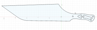

But a baby whale is only 13'Ooops that drawing is 13"
Would one of the pins be hollow for a lanyard? I just like them when swinging hard or when tired.
Which side is the edge side? Hump grind I assume...
Curious as to what you think of it, I've used it on a few.....?So here's what I'm going to do. Jarod has some .186" 80CRV2 he's cutting soon. That is still pretty thick, and would work well for this design. I'm going to piggyback some Sylvans XL on this cut. It will be a new steel for me to try, one suitable to big knives, and heat treated by the best.

I've had a lone experience with a 20" blade in 5160, that shot surprising amounts of vibration up into my palms and wrists if I chopped any wood with it. It helped to reduce the effect if I worked with the edge closer to the handle, but not completely.I made a Gavko Excalibur clone out of it before I was doing this for my bread. I chopped with it. It was tough. But I didn't like the Excalibur design for chopping, too much shock transferred into my hand.
