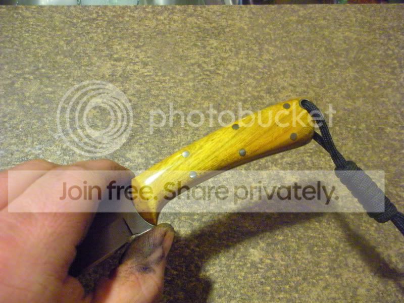

huisache
mesquite
not in that order exactly but they are my favorites.
Dan
Dan, Where do you get the huisache? Online or Local? We have lots of it but all new growth around here.
Sent you a PM. But It was in the Hill Country. It is hard to find big trees, most people hate the stuff and try to get rid of it around here. Just like Osage, around here if you see one in a pasture or on someones property, ask if you can cut it down and they will ask how soon can you have it gone.

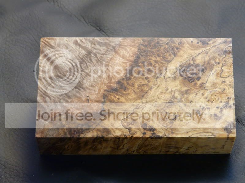

Maybe i am weird but i am a big maple fan. I have seen more varieties of maple than i have of any other wood. Sometimes all in the same piece.
Aside from maple, i love redwood. I am not a big fan of unfigured woods, so i guess any cool, figured wood, be it burl or curled or spalted...I am a fan of them all :D
I don't find that burls work like the rest of the wood from the same tree. The Maple burls I've worked haven't really worked like Maples I've used in other instances. Maybe its because they're stabalized. Same with Redwood. Other woods I just don't have the experience to know the difference. Also, I don't like working stabalized woods at all. And, I don't have good luck with them being 'stable' even though I only buy from the best. I find they warp worse than unstabalized (stable variety) woods with heat, and warp less with moisture. The biggest reason for me though is that they're slippery and plastic-ey feeling. They're REALLY slippery when they're bloody. They make the sale price of the knife high enough that I don't feel like folks will use the knife. I see them change hands a lot on the exchange. I make knives with 01 steel. The steel isn't going to stay pretty forever, so I wind up cleaning up and re-grinding knives that have never been sharpened. I offer this service for free on my knives, and this is the only instance that I really dislike doing the work. Anything can happen when you put that knife back onto the grinder. If I screw it up, I get to replace a very expensive knife that has never, and likely will never be used.
