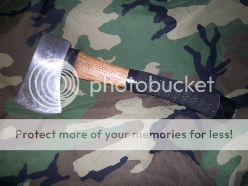

Whatever I get, I know I will end up modifying (some kind of handle wrap for better grip, staining the handle, wrapping the neck with wire and Gorilla Tape for more strength and overstrike protection, lanyard hole if the one I end up with doesn't come with one)...just like I did with my little $14. Lowe's Kobalt Hatchet Project (but with a much better finished product):
Cheap Hatchet Restoration Project: http://www.bladeforums.com/forums/s...ing-a-beat-up-amp-well-worn-tool-back-to-life
Custom Homemade Sheath Project: http://www.bladeforums.com/forums/showthread.php/968283-E-Tool-Cover-Hatchet-Sheath
