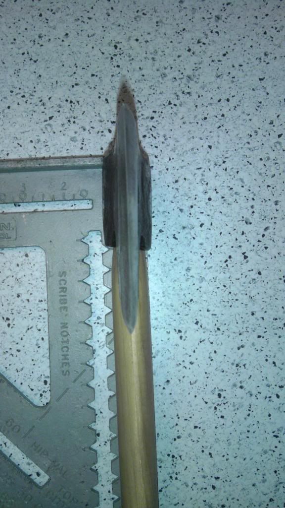

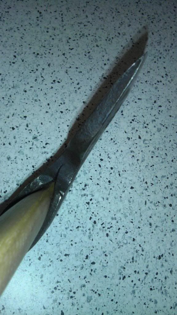

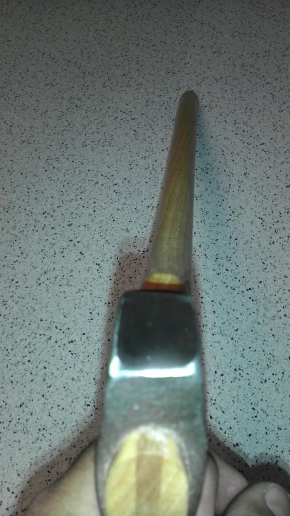

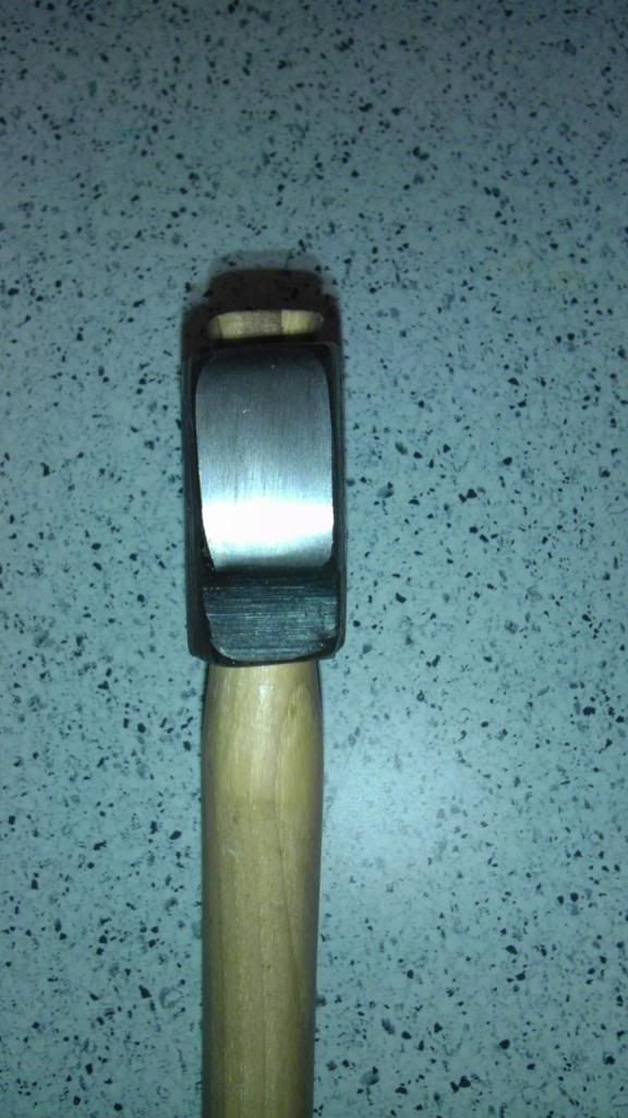

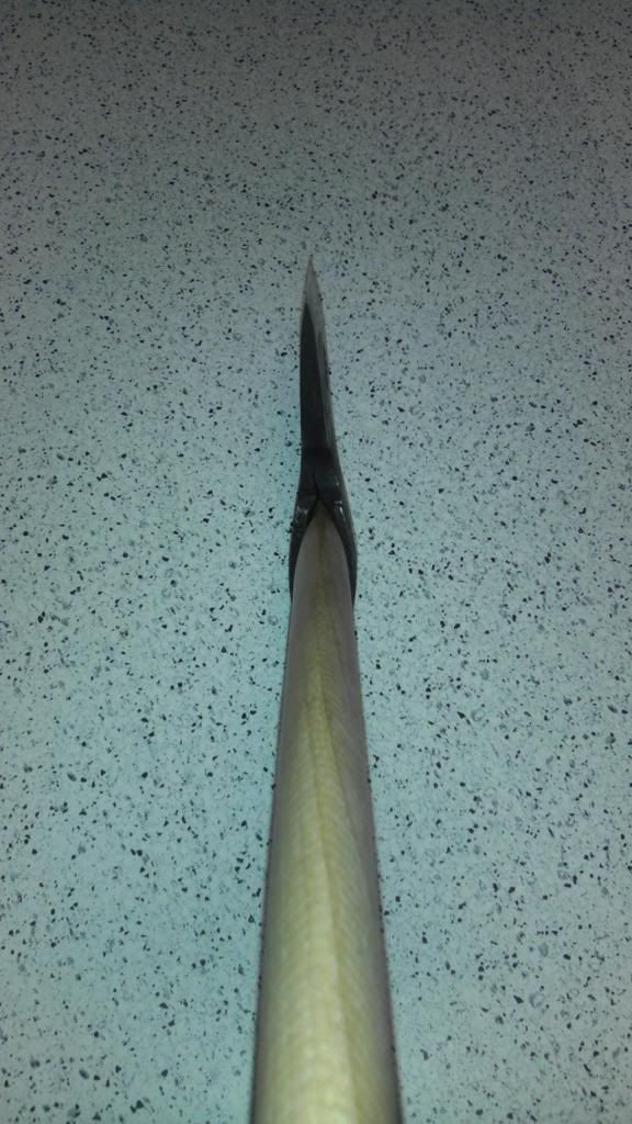

Warning: Rant Ahead
Just got the Wetterlings Fine Forester's Axe and I have to say I'm very disappointed in it.
Maybe I'm wrong. Maybe it's just me. Maybe, because it's hand forged by a craftsman in a small shop that's been around for a hundred years, it's supposed to be as imperfect as I found it to be, but I'll let you guys be the judge of that. Here are (what I consider to be) the deficiencies I found with the axe. You tell me if they are to be expected or if I'm correct to want to reject it.
Issues?
Head is out of alignment with handle; Big time. Handle seems to have been mounted at an off 90 degree angle. It's just a horrible display IMO for what it's supposed to be (a high quality axe). The edge has a rolled over burr at the top and two small chips in it. The little things that I can "work out" I can deal with, but the handle being off "that" much and the edge being misaligned? WTH.
I'll be honest. I wanted to love this axe, but I'm p'd off that something in this condition was even allowed to leave the factory. I wouldn't have put my name on it. I just can't see getting passed this. There is no way such a misalignment can be deemed as acceptable for something that could put a hurtin' on you with just the slightest loss of control over it. A misaligned head/handle is dangerous. Period.
